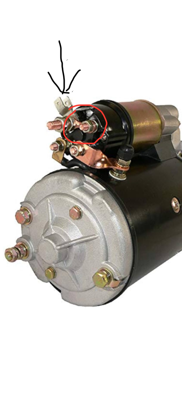

If you are making connections to the starter solenoid as Jim shows. Remove the battery cable from the terminal circled in the photo I attached showing Jim’s connections. Remove all smaller wires off that terminal and only put the battery cable and the lead wire as shown in Jim’s diagram. Tape the wires back that you have removed. This will cut power to all the original tractor wiring and help assure no other shorts or damage will occur during transport.

I meant the starter terminal on the solenoid

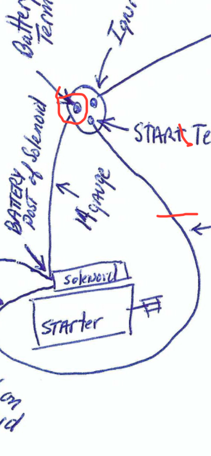

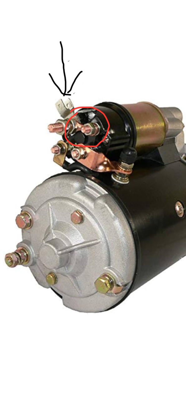

It is circled in the photo, hopefully that is the same as yours. If you have wires on the spades that the arrow points to unplug those. Those are the wires I asked you to disconnect in the last part of my reply 194. And hopefully there are no other small wires on the actual terminal it self only the battery cable. If a regular female spade terminal will plug on those terminals shown by the arrow you can use that to connect to the wire you are running to the “battery power terminal” Jim shows in his diagram in post 153.
It is circled in the photo, hopefully that is the same as yours. If you have wires on the spades that the arrow points to unplug those. Those are the wires I asked you to disconnect in the last part of my reply 194. And hopefully there are no other small wires on the actual terminal it self only the battery cable. If a regular female spade terminal will plug on those terminals shown by the arrow you can use that to connect to the wire you are running to the “battery power terminal” Jim shows in his diagram in post 153. View attachment 83242
Well so far I've run wire to fuel shut solenoid and ignition wire from switch to place where positive cable goes to on starter solenoid. the picture of yours is not like mine. I have another small black wire attached to the solenoid which I have used a jumper on when bypassing the ignition. now please be patient I'm trying. now do I run wire from battery terminal on switch to a.wire on the solenoid.
