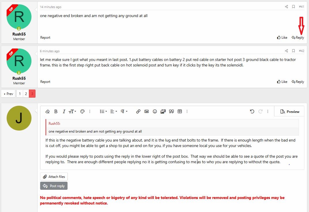

If you would please reply to posts using the reply in the lower right of the post box, not put your reply in the box below the post. That way we should be able to see a quote of the post you are replying to. There are enough different people replying no it is getting confusing as to who you are replying to without the quote. I used the reply button (red arrow) in your post so you should see your post I am replying to for an example. I will back out now.
