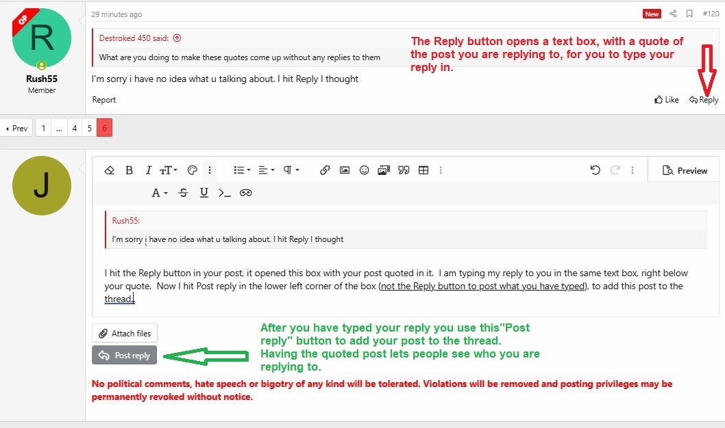

I'm sorry i have no idea what u talking about. I hit Reply I thought
I hit the Reply button in your post, it opened this box with your post quoted in it. I am typing my reply to you in the same text box, right below your quote. Now I hit Post reply in the lower left corner of the box (not the Reply button to post what you have typed), to add this post to the thread.
Also, do not go back to the post you are replying to and hit the Reply button in that post box to send your reply, use the Post reply button at the lower left of the text box you just typed your reply in.
