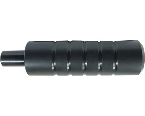

Tip ,use one of these tools and you won’t mushroom the the pilot bushing.

and there is a tool for that also. who hammers on a pilot bushing ???🤷‍♂️
You would be surprised and sad at how often it's an issue. Lots of younger folks are buying and working on Cubs. They just don't know, but I'm happy to see them buying, fixing and using old stuff. They can learn 😁
