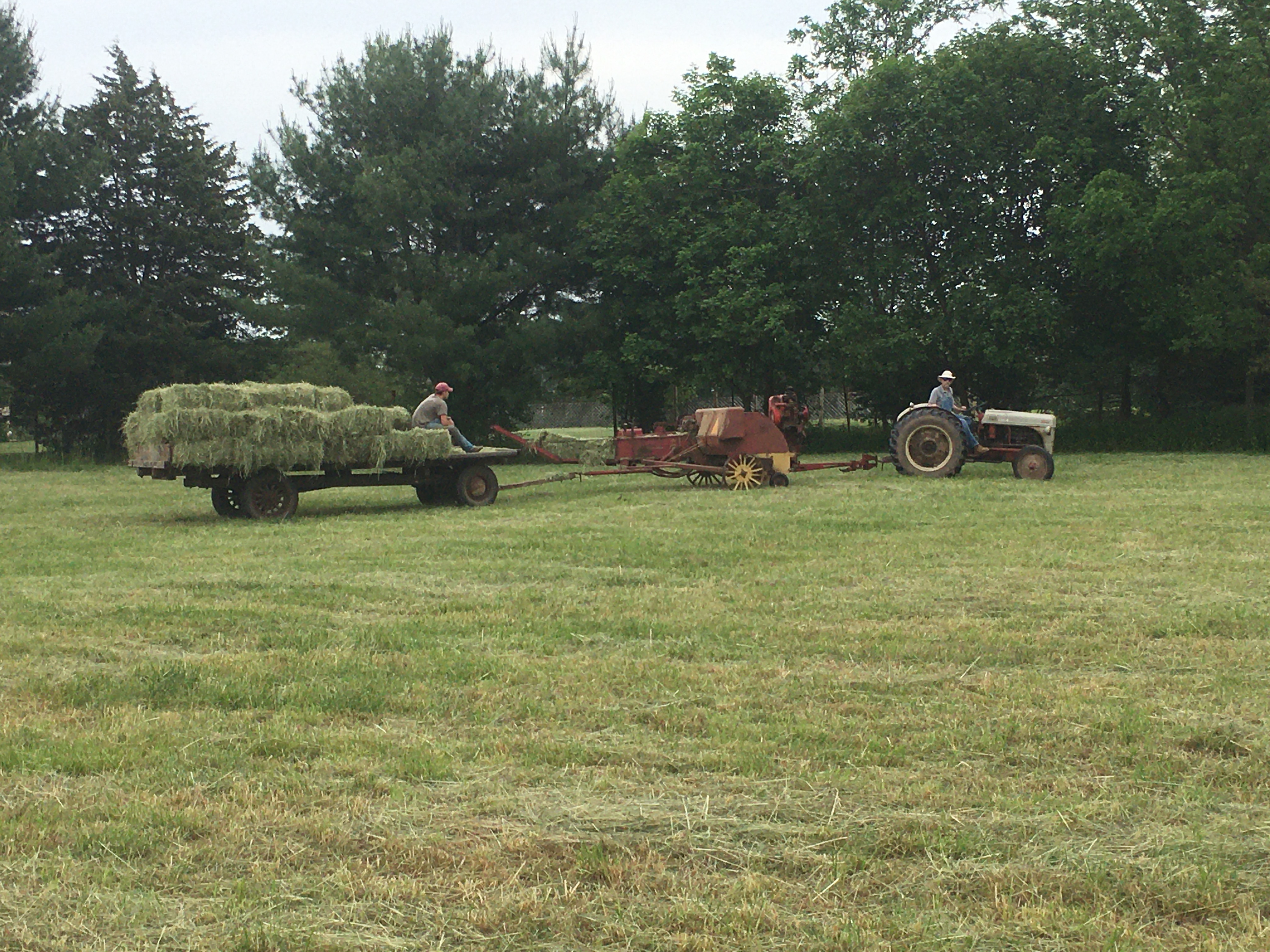

baling hay doesn't take much power. The only really important thing is live PTO.
That all depends. First cutting alfalfa-timothy at 3 tons per acre, loading a wagon via a thrower, pulling that wagon up and down a grade of 8-10 percent, and hustling along at 4 MPH or more to beat the coming rain requires more than 25-30 PTO HP. Don't know of any production type operations running an 8N or Farmall H on a baler around here. Sure, they can be made to work in a lot of situations but there is a trade off.

I agree. Our fields have some decent inclines. We bale small squares with our Oliver 1750, New Holland 271, and a flat wagon behind it. Use the same tractor on the round baler. With the ups and downs you wouldn’t want a smaller tractor. We aren’t flat landers and yep a smaller tractor wouldn’t do much here on our fields. An old Ford 2n, 8n, 9n may work for some, but here they are better suited to a brush hog or smaller tasks. I’d never pull a loaded hay wagon here with that small of a tractor. Just not safe. But to each his own.
