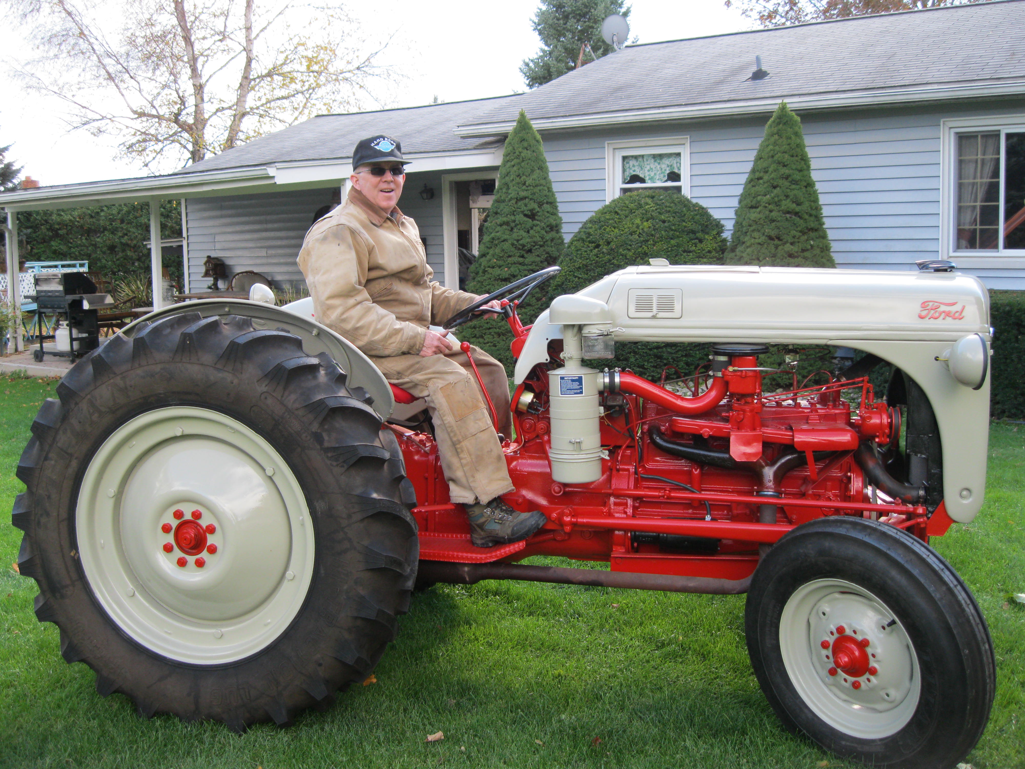

When I filled the tires on my 8n, I got a 55 gal. drum of washer fluid from the local auto parts. I used it (27.5 gal.) + about 5 gal. of water in each tire. I wouldn't mix any more for my area. So far (10+ years) no freezing.Can you mix windshield washer fluid with water if so what would measurements be just wondering want to keep expense down

How much was it for drumWhen I filled the tires on my 8n, I got a 55 gal. drum of washer fluid from the local auto parts. I used it (27.5 gal.) + about 5 gal. of water in each tire. I wouldn't mix any more for my area. So far (10+ years) no freezing. View attachment 72424
