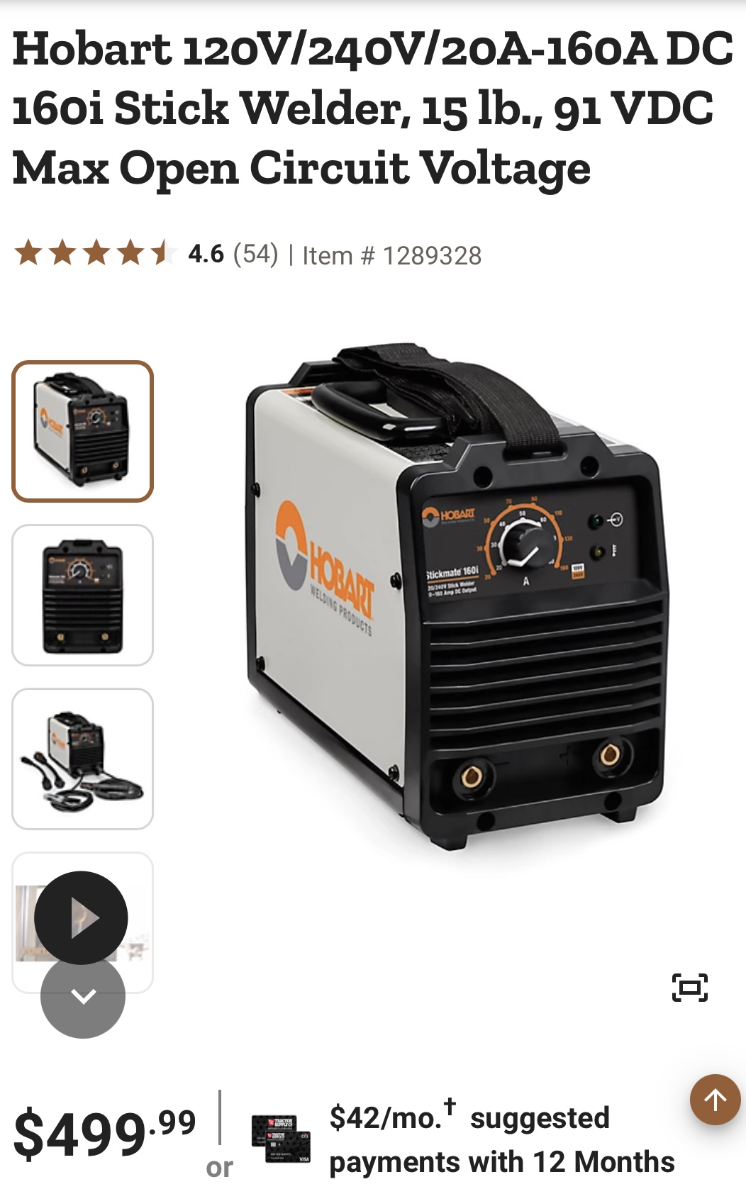

Been looking for a new stick welder to replace my Lincoln tombstone ac welder that doesn’t work anymore.
Found this Hobart 160 dc welder on sale at tsc so I ordered it.
To me while it may be made in china Hobart is still a top brand with a good warranty.
It’s only for around the house use and I feel more comfortable with a stick welder than a wire feed.
It’s small enough I can run it off my generator for use out in the field.
And it was on sale 50 percent off.
$500 list for $250.
So give it to me straight.
Is this a decent low cost welder for 4 times a year around the house use or at least better than some amazon never heard of the brand before item.

Just because it is made in China means nothing.
A company like Hobart that sells many models way more costly does not want entry level welders to be junk welders.
So I would think that Hobart is on top of their quality requirements for products made in China.
If the entry level stuff is junk, they lose customers buying a bigger more expensive model in the future.

Once a "top of the line" proud US made company Hobart welders are now "the residential/hobby brand of ITW (parent company for Miller). For a while Hobarts were just rebadged Millers, but now they aren’t flowing the fancy stuff down to Hobart". (From the 'net.)
For the $250 you could have replaced your Lincoln with a good used, or fixed your original. To say the little suitcase welders are for Hobbyist's is Very kind. Best if your time and projects are unimportant. "Lest we forget, the Bitterness of Poor Quality remains Long after the Sweetness of low Price is Forgotten."
The residential/hobby brand of a well known brand like miller sounds good for my use.
I’m not looking for top of the line for how seldom I use a welder but didn’t really want junk either. This welder sounds like it will be a good compromise.
If you can get 130 dc amps through 1/8" rod, then it will weld anything you would ever want. You can weld inch thick steel but it just takes more passes. That's how the big stuff gets welded such as pipelines. First one may use 6011 and the rest are 7018LH. I imagine it will handle 3/16" as well but that is big for everyday welding of 1/4" steel.

First question I ask about a welder, What is the duty cycle. Most of those things that I have checked on have a very low duty cycle and when you get up to about 75% of the rated output the duty cycle goes to basically nothing. I would not buy anything that had less than a 60 % duty cycle at the maximum rated output. Anything less than 300 amps is about useless to me. It takes that much amperage on the top side to get The 60% at about 75% point. I burn lots of 1/8 and 5/32 & 7018. @ 150 to 175 amps. That little fellow probably wouldn't last me 1 day. I bought a new Lincoln 225 TIG and Stick machine a while back. I didn't do the research I should have on it. I had a good size TIG aluminum job to do, that required about 200 amps. I burned the machine up in 30 days. Lincoln repaired it under warranty. They claimed they put $1200.00 worth of parts in it. It is all about your needs and how you are going to be using it. It may be perfect. We have 2 little Hobart Handler MIGS we use for light sheet metal and they have been great. It takes a dang good welder to stand up to burning a 50 Lb box of rod in a day. and I have done it many times in my life.

Looks like a 110/220V machine too, so you'll be able to use the full capability of the welder. Those 110V ones can overload a 15A circuit, and it's not often you have a 20A circuit around. They tend to be very sensitive to extension cords as well.
I think you did fine.
Yes sir the duty cycle is important. Doubt many homeowners do enough for it to be a factor.
Input 220 v at 27 amps
Rated for 3/16 rod on 3/8 steel.
30 % duty cycle at 160 amps
100 % duty cycle at about 90 amps

John. After you get it, here is the test for the naysayers. Crank up the amps to 160 or so and use whatever rod you have which is probably 1/8". Take a scrap piece of 1/4" or thicker plate or angle iron and starting an inch from the edge, start burning through the plate like the rod is a cutting torch and cut one inch or more slices off the steel. Start the timer on your phone and track the time and number of rods it uses before the duty cycle shuts it down. Post back with results and pics.
Repeat the test, or do this test first, just running beads until the duty cycle shuts you down.
While you are at it, practice making the cut without leaving slag on one side. Usually any molten slag comes off easily with a grinder.
