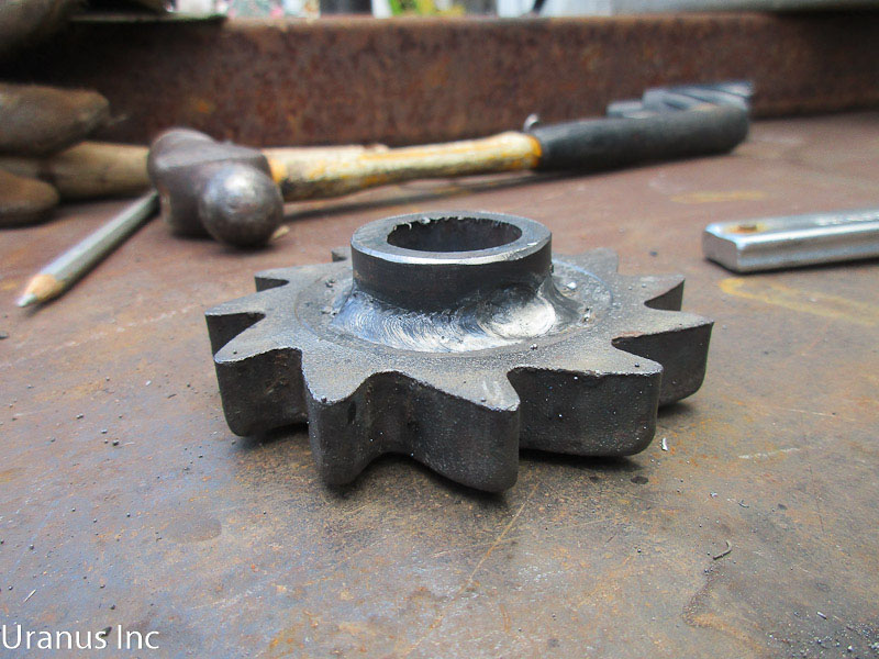

Also have a cheap little Lincoln MIG that a friend gave us. I'm definitely not too proud to point, squeeze and weld with a little bit of Argon/CO2 shielding gas.
Was sure handy when we built up the twine finger cam on our baler... took about 30 passes... and no slag to chip in between.
It's SUPER nice on sheet metal. About the same learning curve as using a hot glue gun.

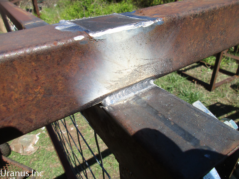

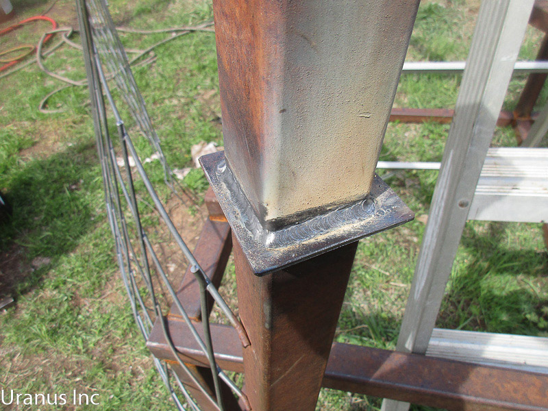

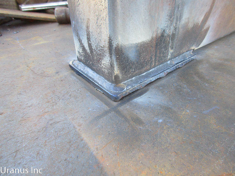

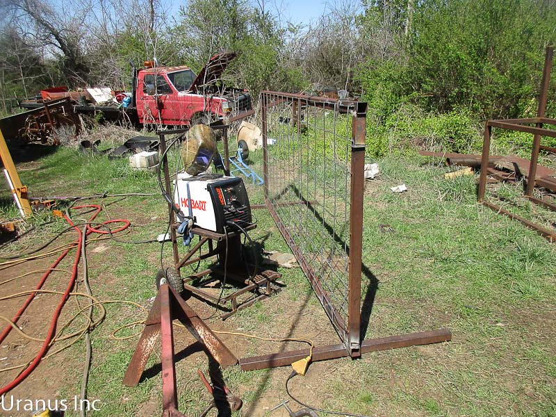

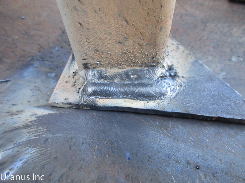

I had 2 Hobarts fail in the identical manner.
Both welded fine until they didn't.
Running good.......................
Even when pushed beyond what it' supposed to weld. This material is too thick for a little baby welder.
When run on material it was designed for. Beautiful arc, nice welds.
Fast forward a few pounds of wire, AND I MEAN A FEW POUNDS.
Intermittent arc, virtually no control over heat input.
Will not run unless the voltage is turned to max, and wire speed(amps) through the roof. Pure crap.
I had a whole host of well meaning folks tell me it was the usual popular internet problems. Wire tension, roller tension, etc etc etc. When I knew damn well it had to be something in the wire feed control. Which means the PC board...........it's the only thing that controls wire speed.
I was able to find a copy of the actual Hobart tech manual for the machine. Same manual used in the repair shop. These are out there floating around on the internet, if you know where to look. Miller will not release these manuals anymore. Not terribly complicated.......just some basic checks to isolate the problem. Manual is set up in the module form. Ten minutes, and I was on the phone placing an order for a new board.
Back to normal............................

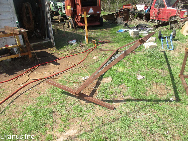

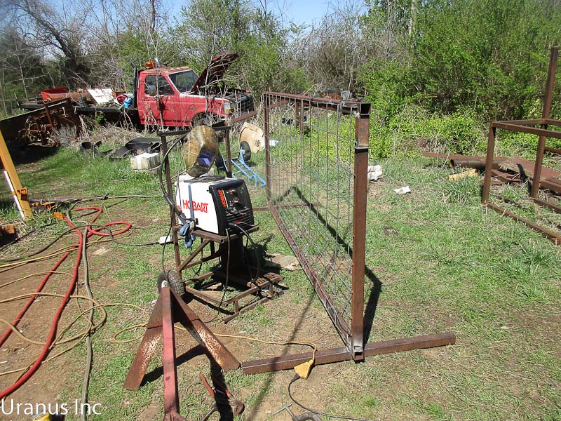

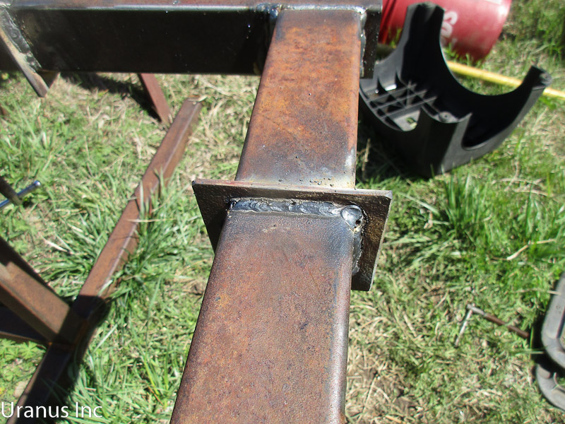

BTW..............................................

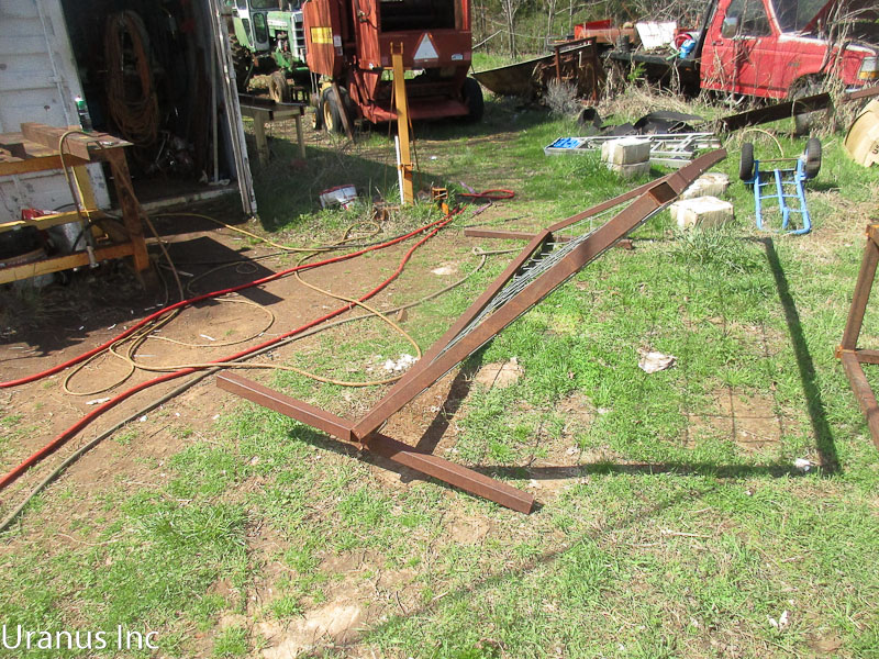

Panels, and tractors, don't get along well
Sumpin' to do with old age I guess. It looked like I had enough room to clear it.
Panels, and tractors, don't get along wellView attachment 97170
