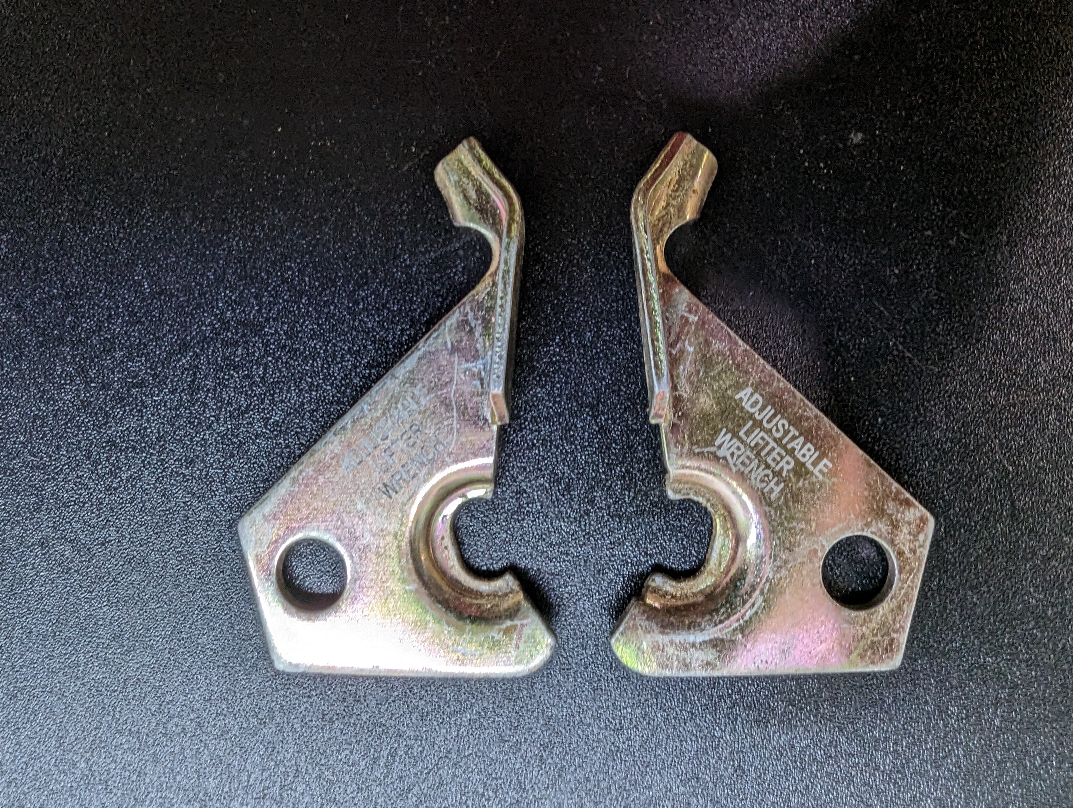

Adjusting the lifters with these was fairly easy. View attachment 67432
Yeah, that's the ones. I figured if they work good I wont have to drill holes in my block.

If it makes you happy lap'em. There is nuttin wrong by learning the hard way. BTW that cast iron block drills like butter its gonna be a little to late once you get it together and find out those wrenches break.
I did hear the cheap wrenches can break. I dont see having to adjust the valves often as it wont get used a lot. I know it would be easy to drill but I wanted to avoid it.

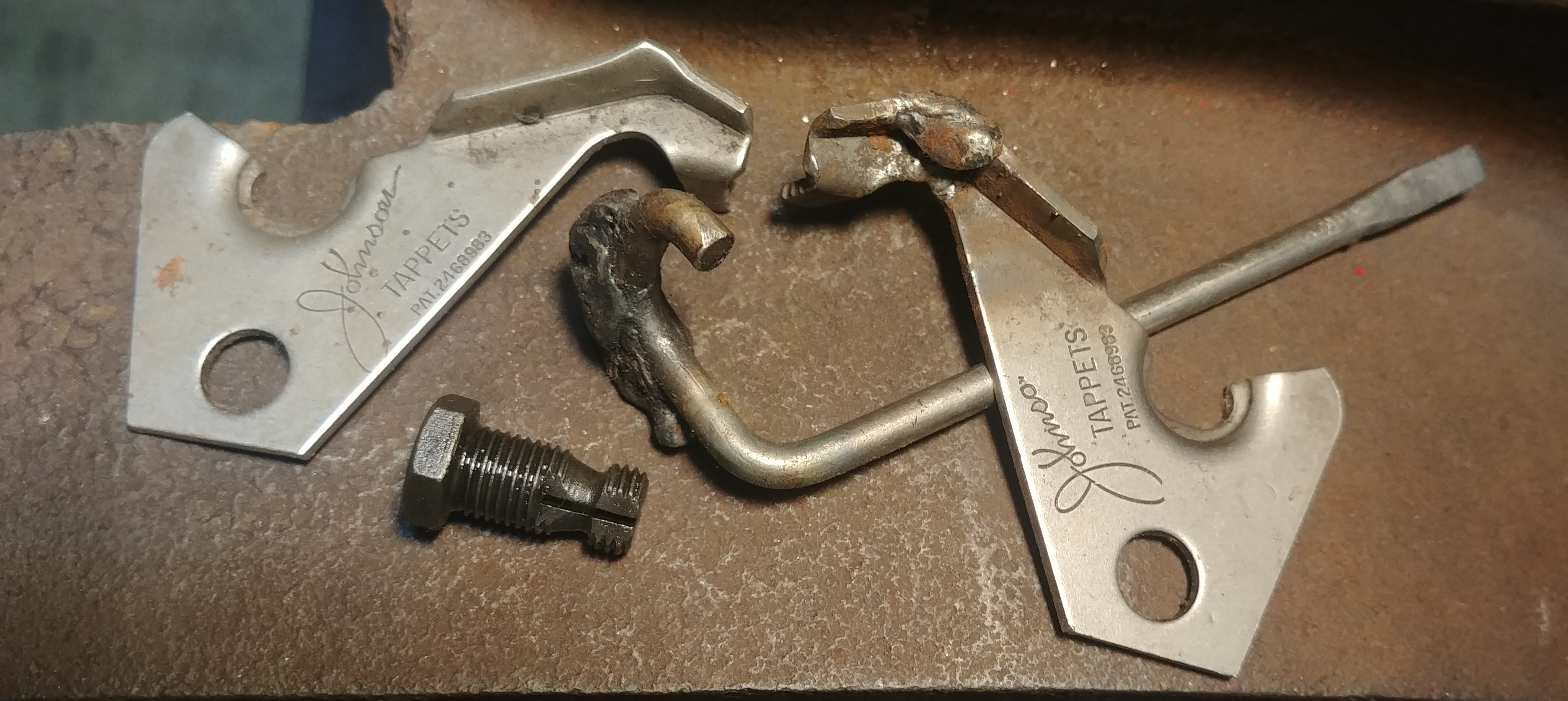

Mine broke years ago on the first one. Welded it up. Still no good. Sacrificed a cheap screwdriver. It bent. Welded on the bend to thicken, and got it to kinda work.
Drilled blocks worked 100% in my experience. That tappet bolt can take some torque to turn.
If wrenches bend, then what?
Drill with tappets in?
Hi JJay48,
