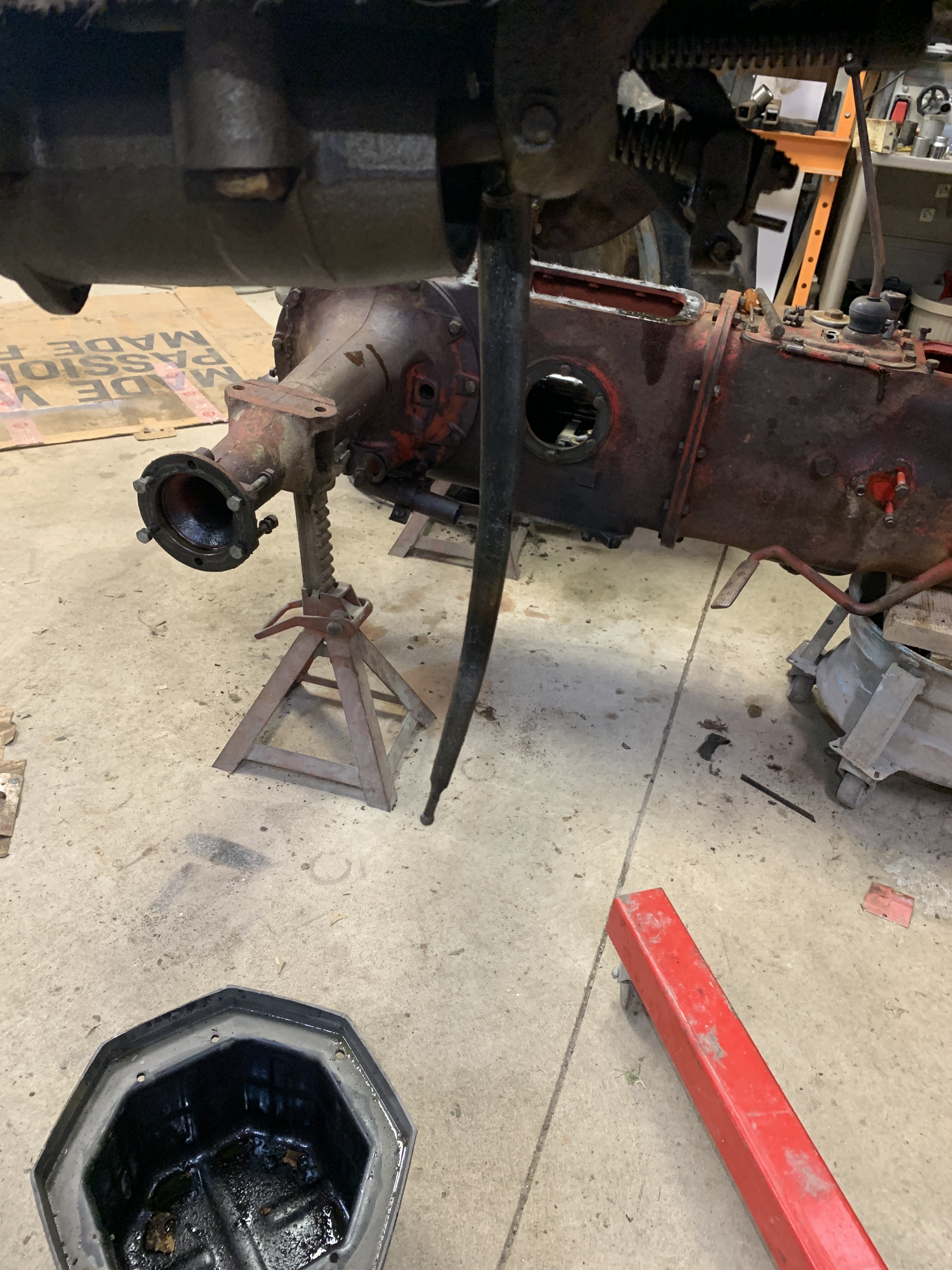

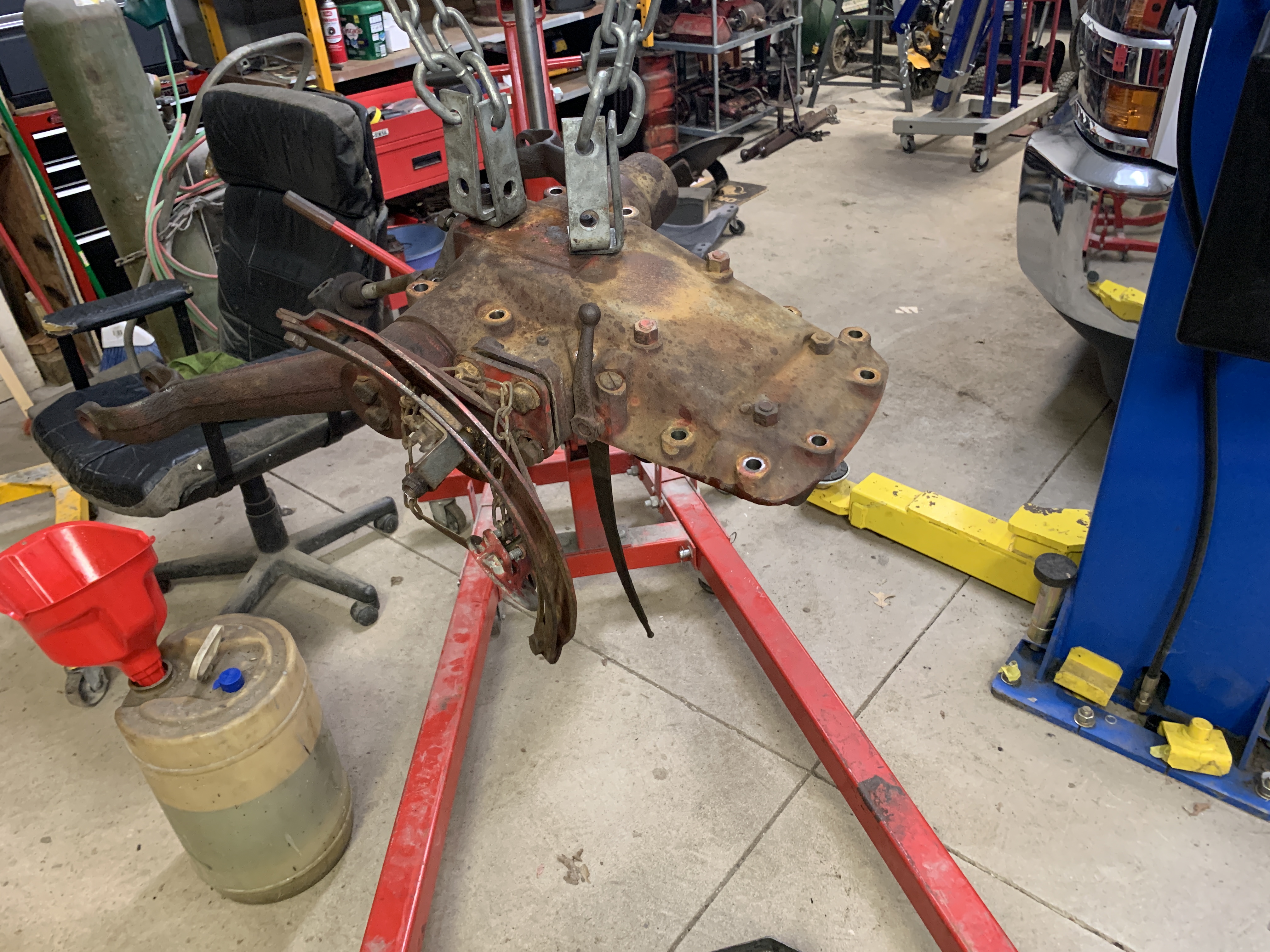

Pulled the trans this evening. Now I want to pull the axle housings and the rear diff. Then I may get the cases dipped in acid. Lots of rust on the inside in spots too. Especially the transmission but I think the gouges in the lift cylinder were from the rust.

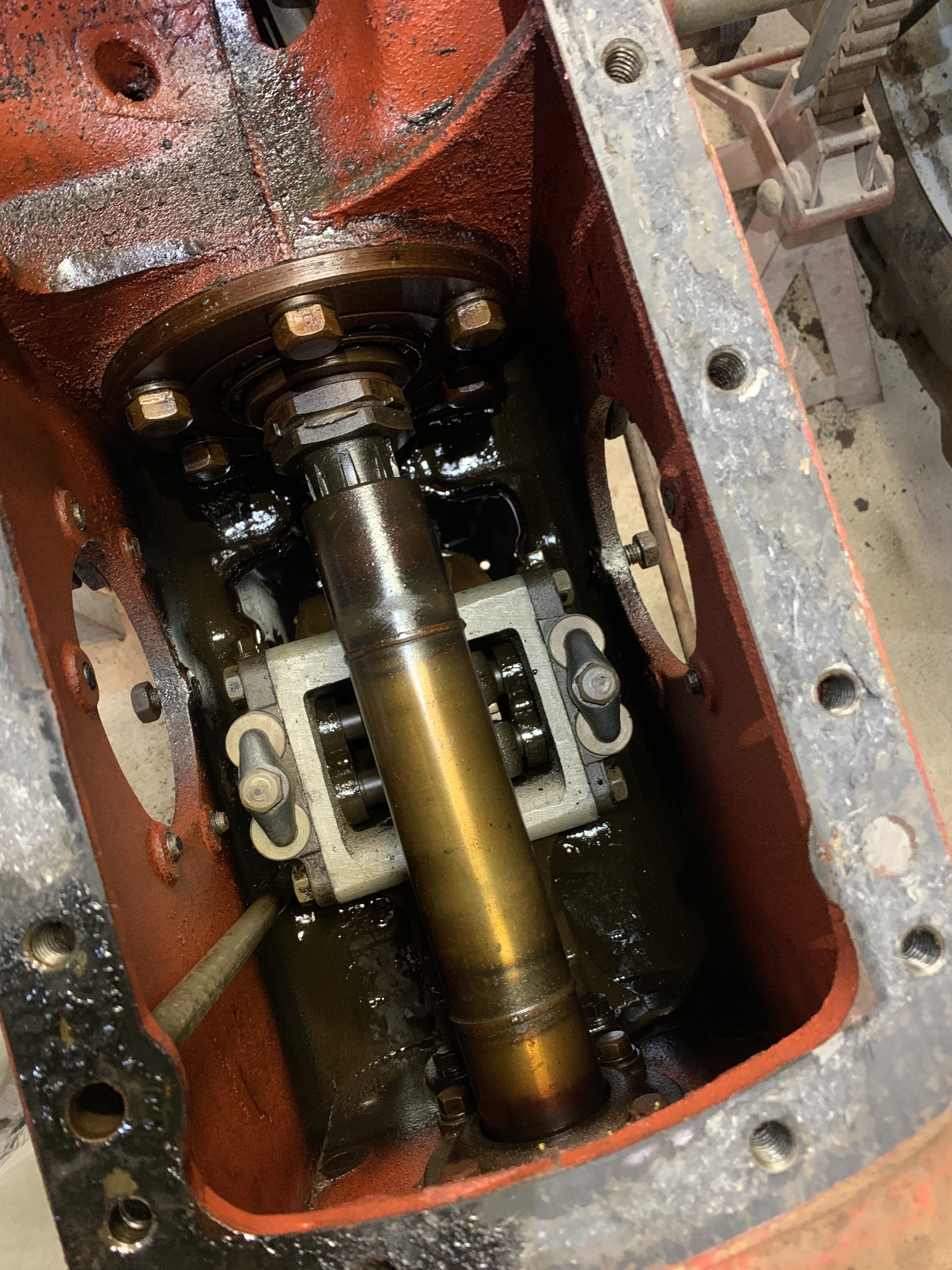

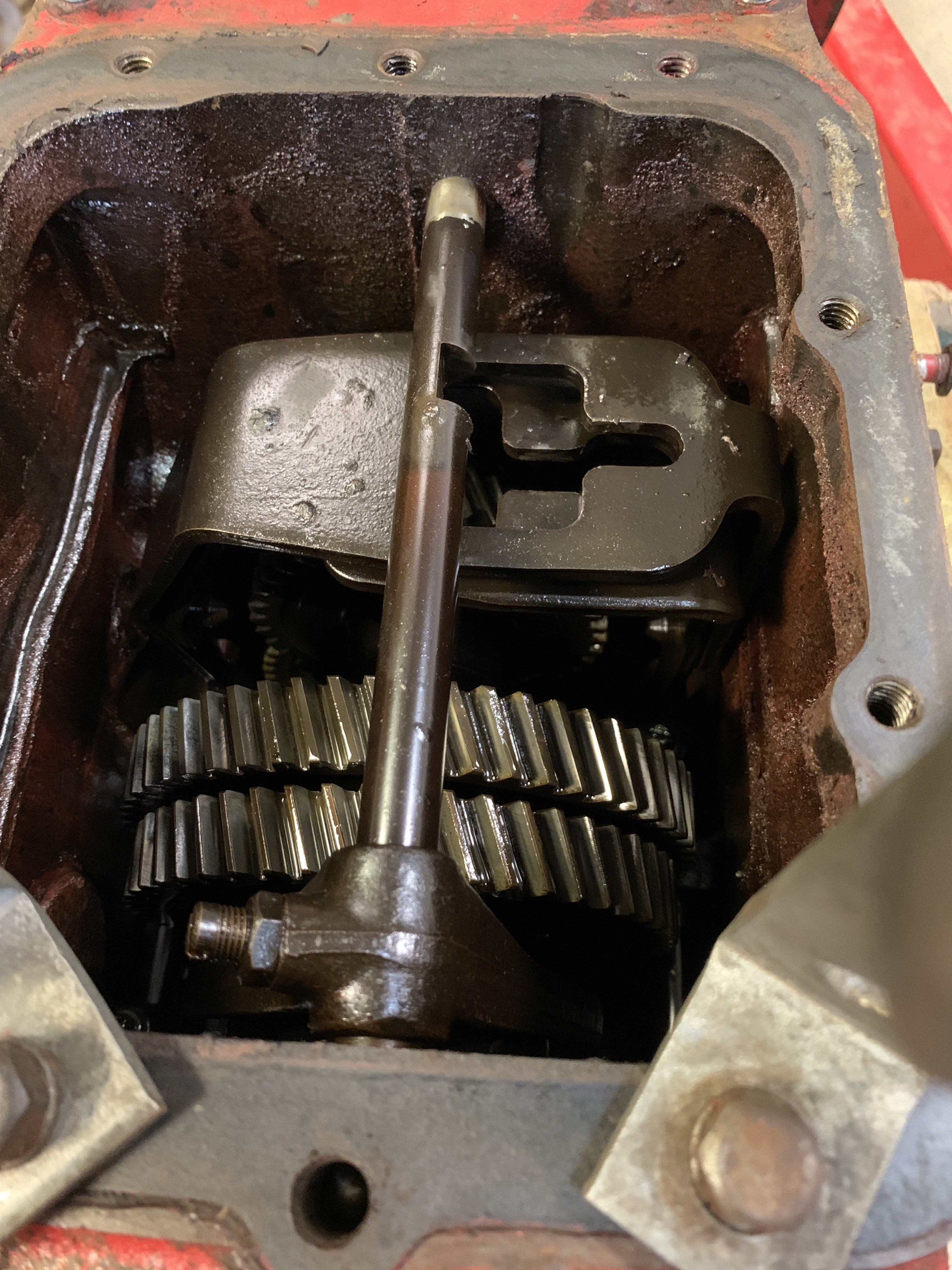

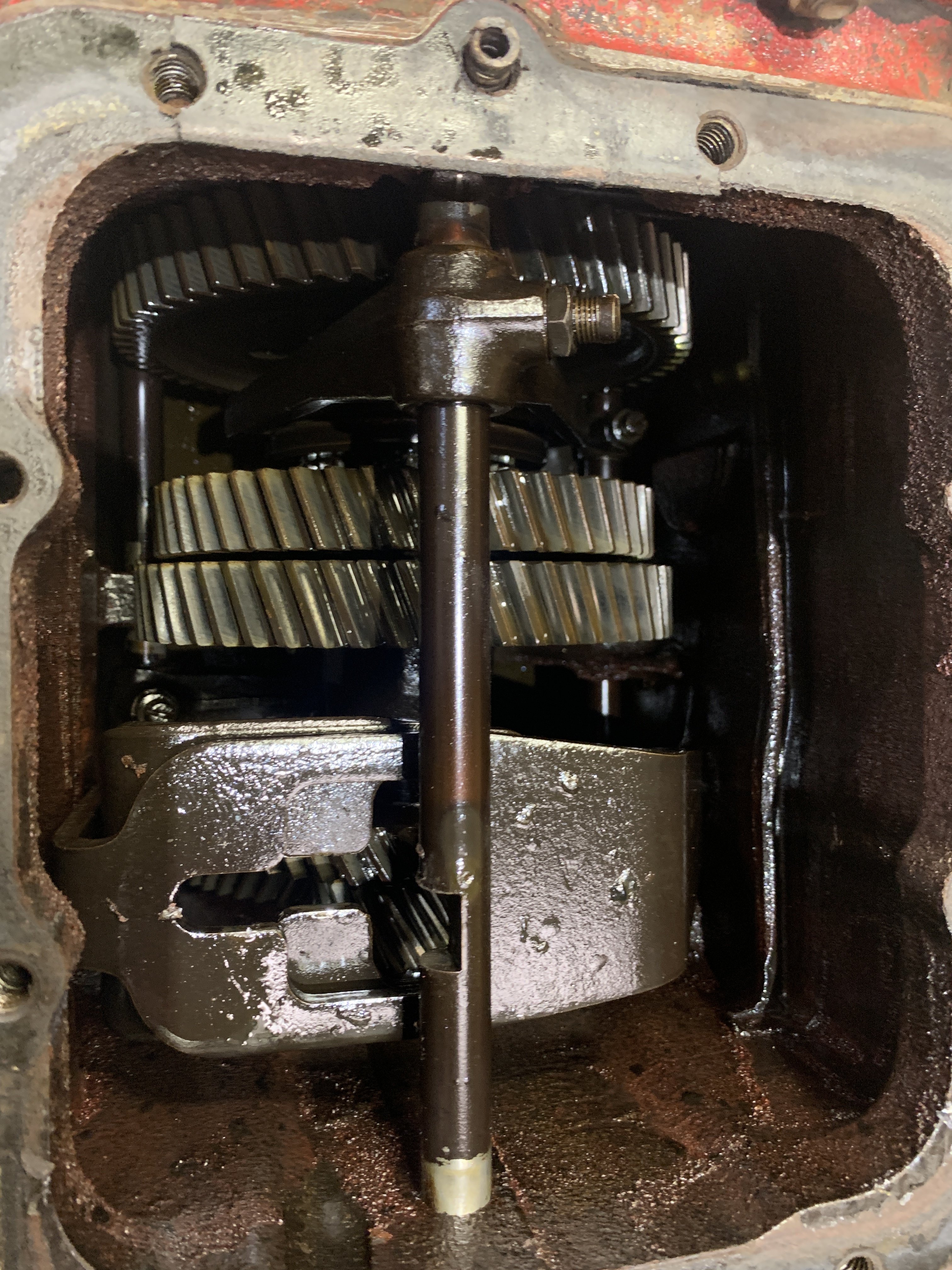

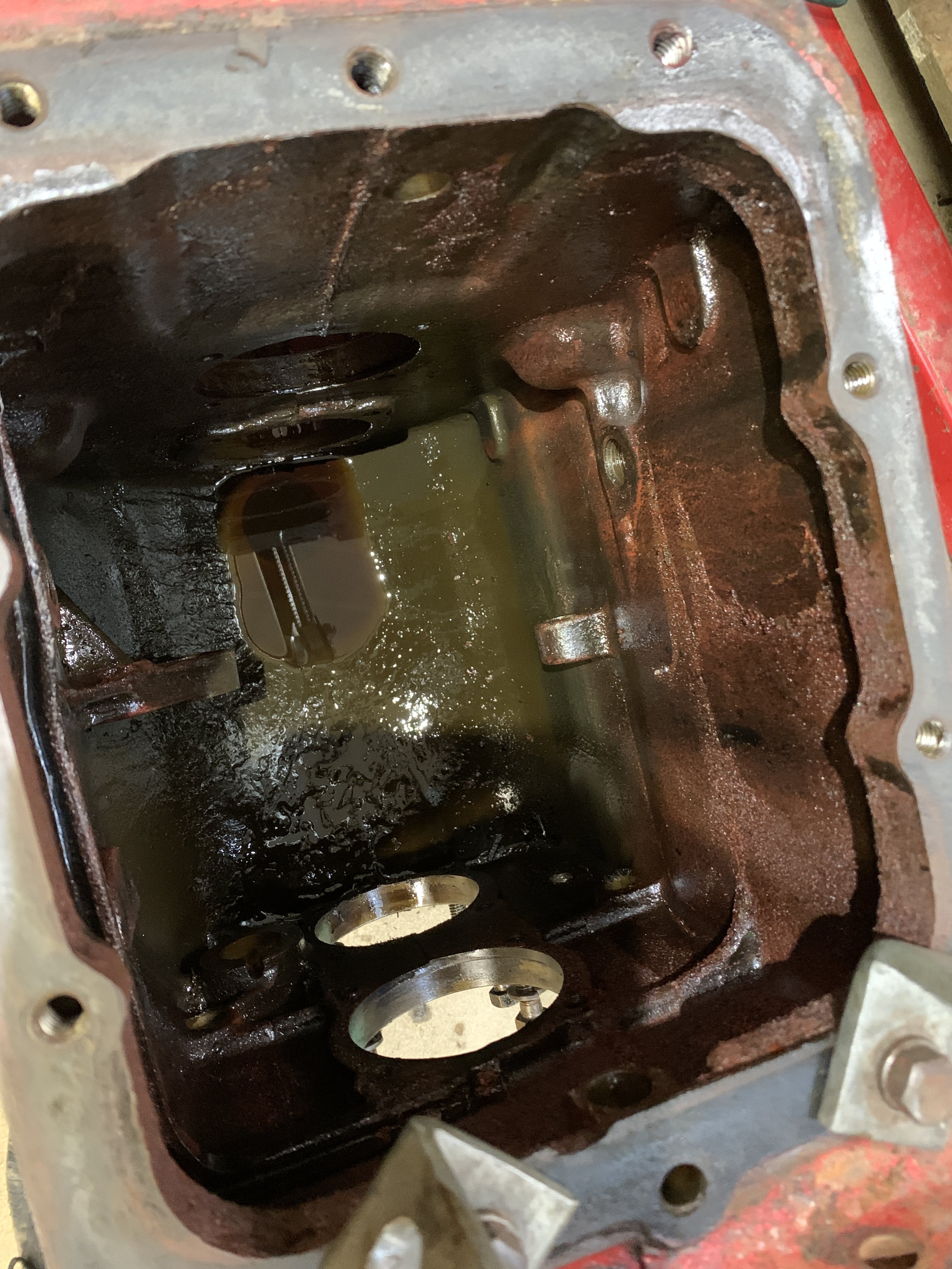

Took the trans apart this evening. Glad I did because it was pretty nasty inside the case. Now I can dip the case and paint it once I get the clutch rod out. Thinking about replacing all the bearings and races too. Gears looked good though.

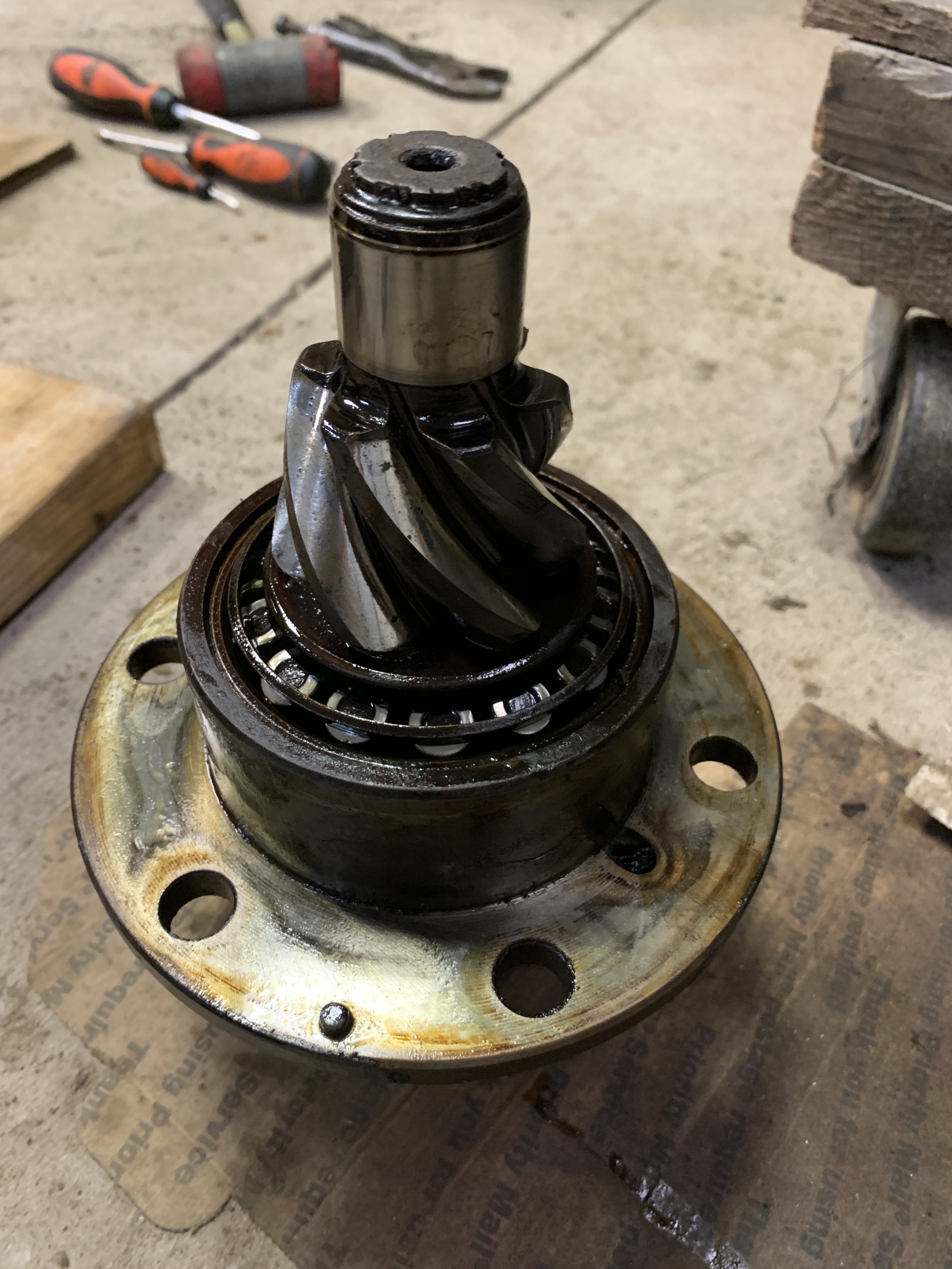

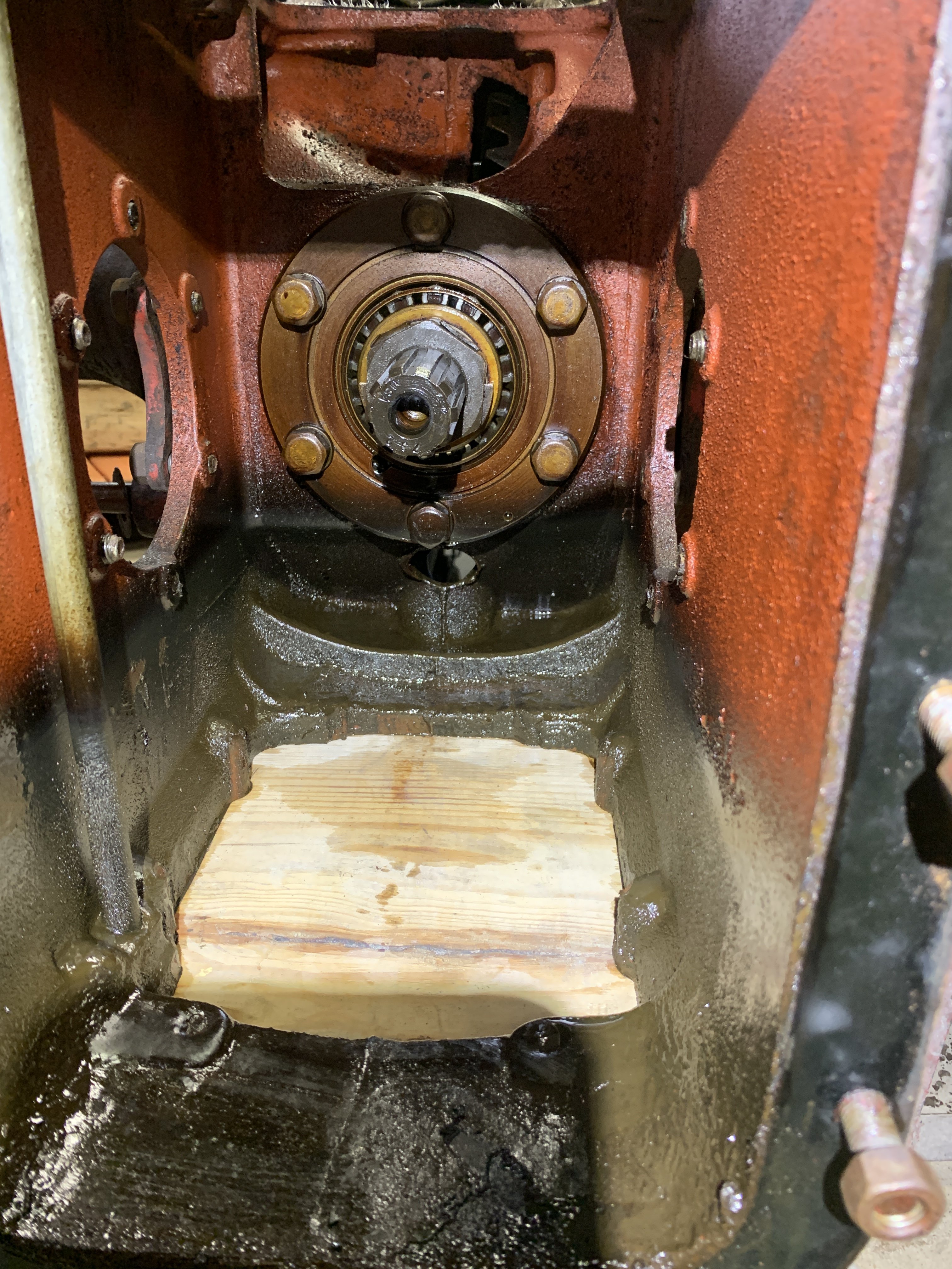

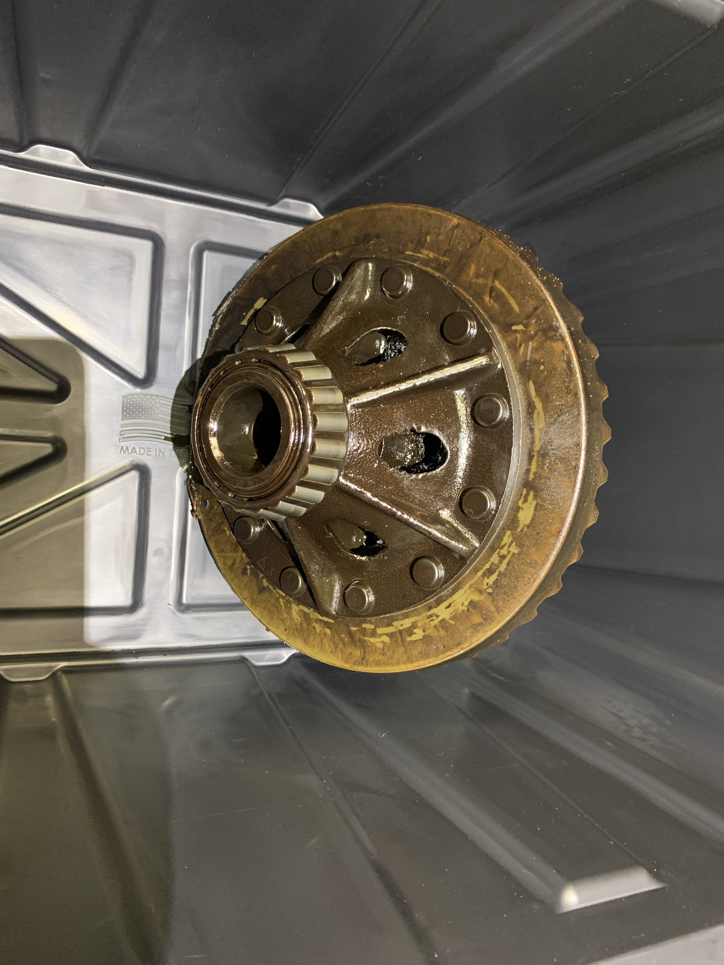

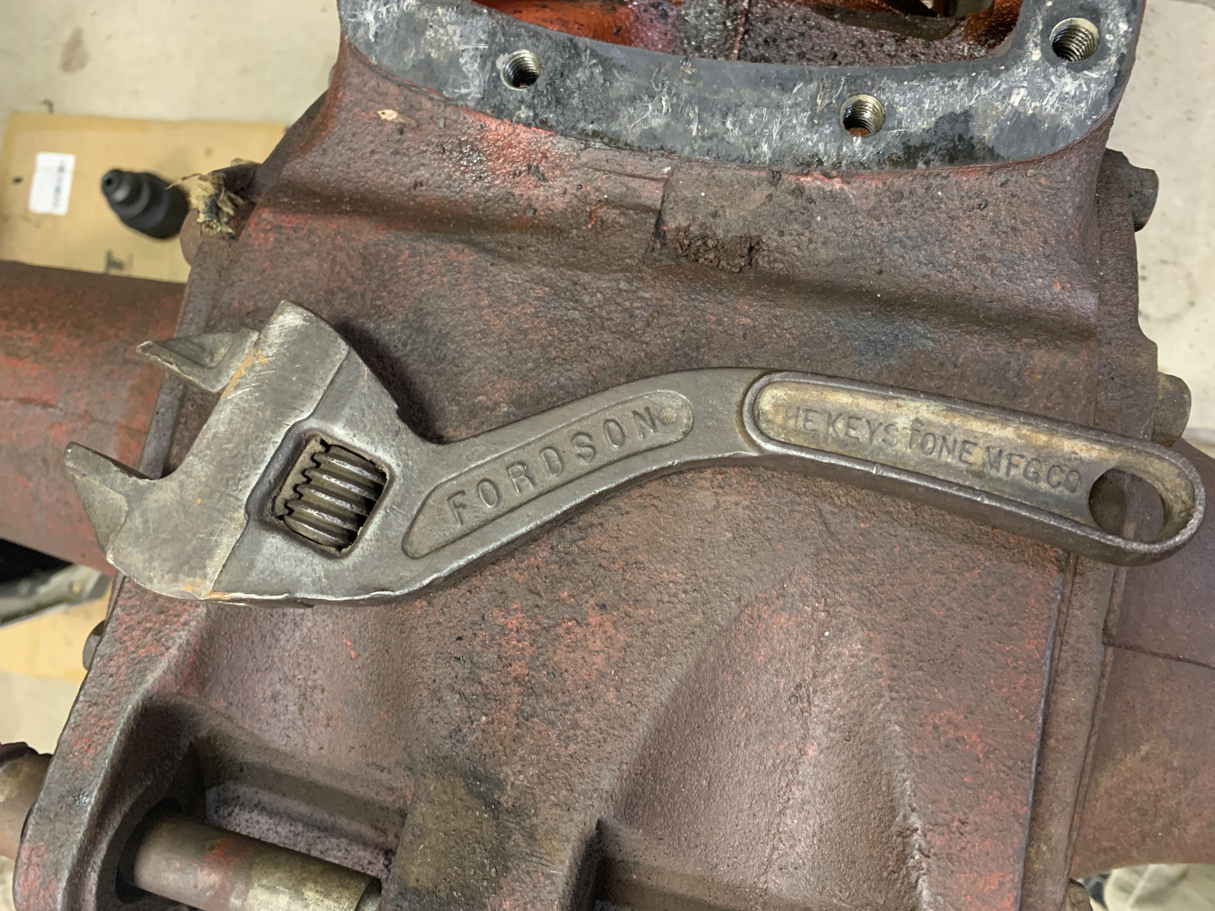

Got the rear diff out this evening. Still need to get the pinion out but it was not coming easily and was getting late. Almost ready to start cleaning everything and getting it down to bare metal.
The end of the pinion on the front side has a threaded hole, remove bolts that retain the bearing housing thread a slide hammer in it and pound away.
Thanks! Hopefully it comes out easy enough that way. The bearings on the pinion were actually pretty good still with no slop.

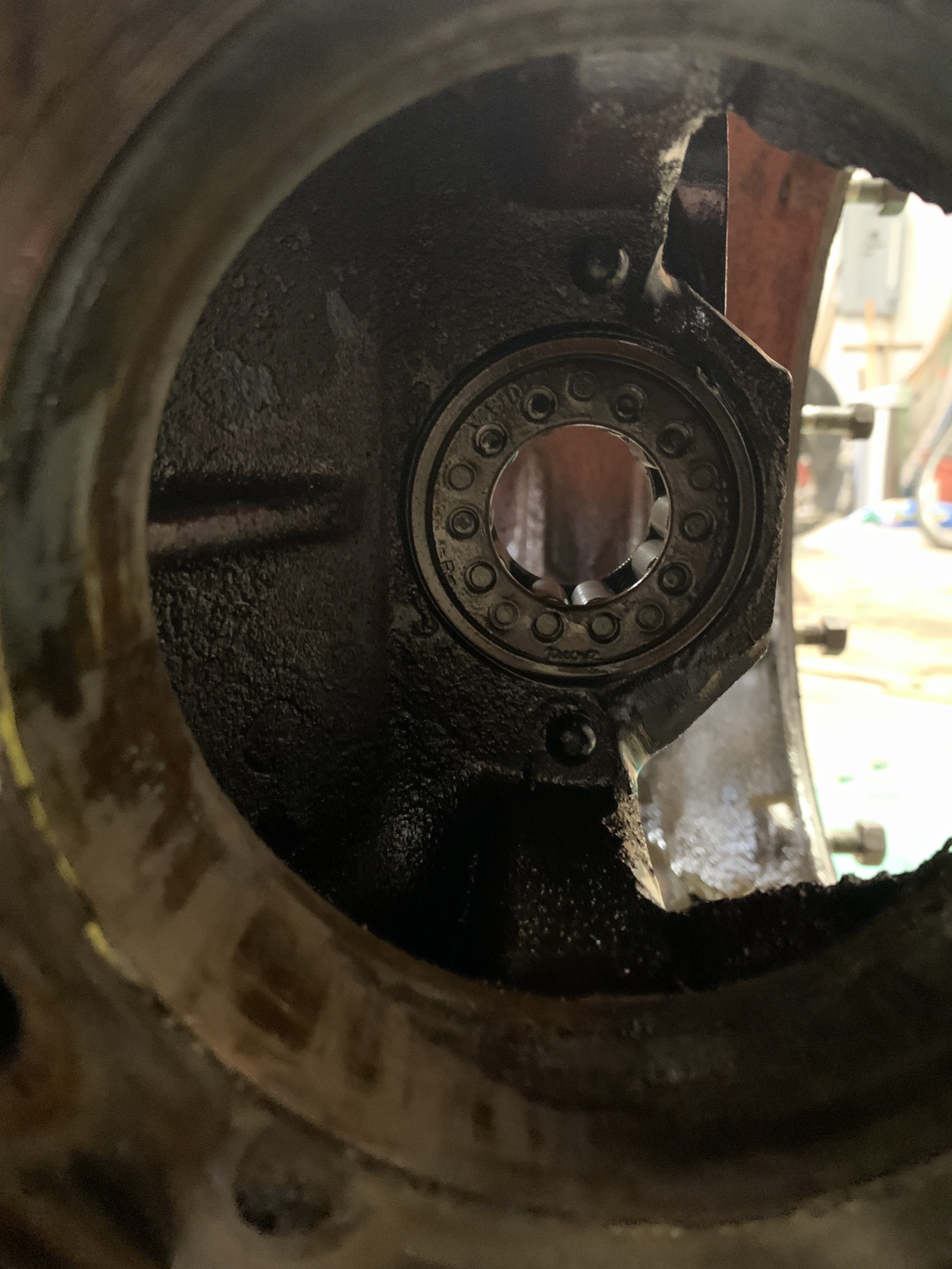

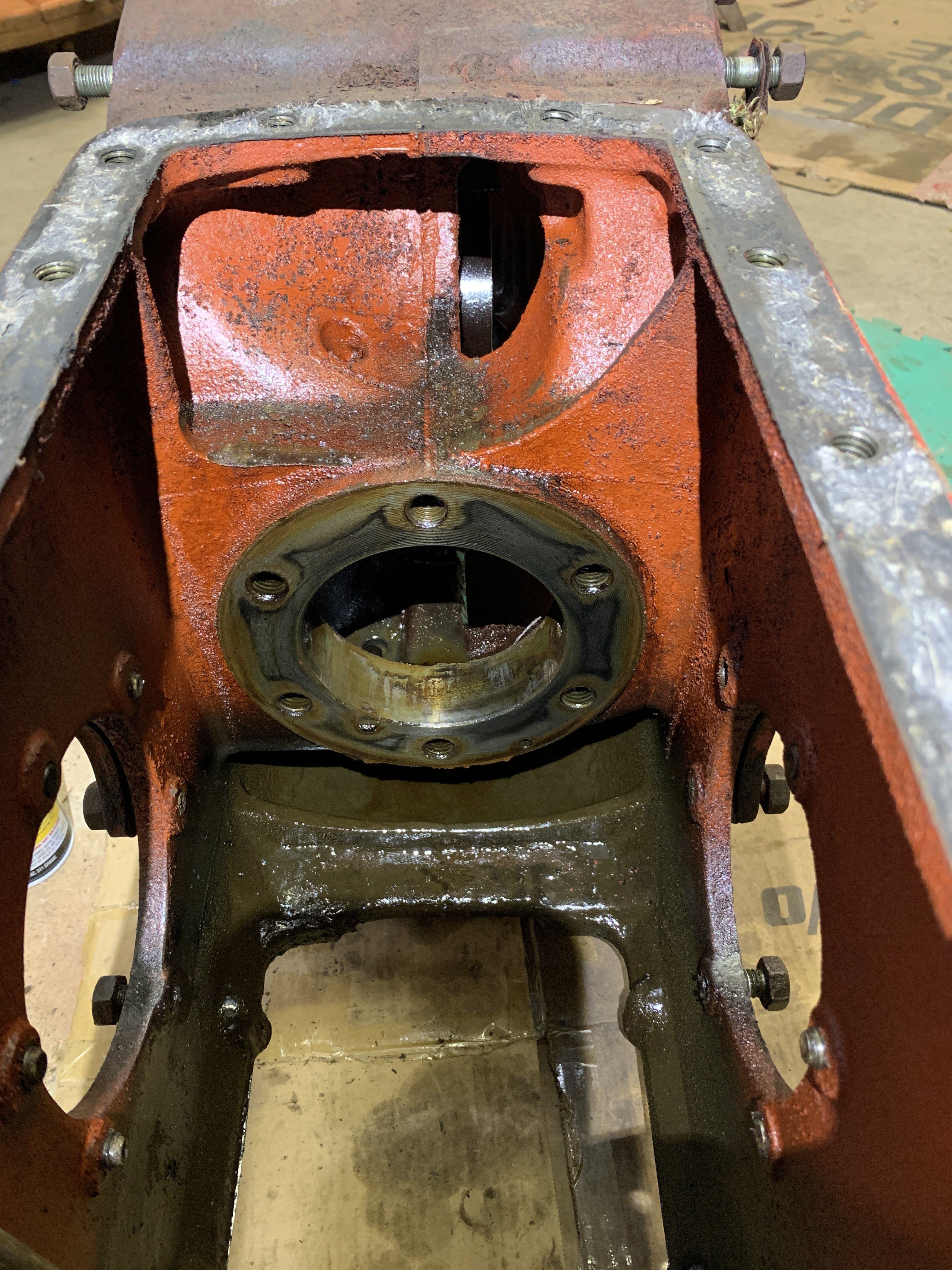

Ok. So I got it out with the slide hammer and the inner race of the rear pilot bearing came with it. Not sure if that should have happened or would have if I removed the snap ring beforehand. I also noticed the 2 nuts that lock together on the front are loose but there is no slop in the large pinion bearings somehow that I can feel.
Not much info out there on taking one down this far that I can find. Probably need to grind the head off the rivets that hold the oil shield in to get the pilot bearing out. Looking at the new pilot bearing part number it doesnt even look to come with the inner race.

Clean it up if the bearing race looks good leave it be. You can tighten the jam nut and move on with life. On the small bearing I have removed a few I never removed that plate. I would clean it in place if all looks good run it.
I would clean the transmission housing, trans and the rear parts and move on there is no need to hot tank them. BTW if you hot tank are bake you will need to redo the RED paint.

I was planning to redo all the red paint inside the case. Especially since there was none in the gearbox and it was pretty rusty.
Can the small pilot bearing be pushed out the front then? It looked like it wanted to come out the back but the oil shield was holding it in.
I would leave well enough alone but I am in this now. I may as well left pinion in if I dont follow through with the plan. I dont know though going to think on it. I really wanted to dip them and repaint it inside and out. Guess ill see how good it looks after some initial cleaning.

I would have to go look at my case stash, I have never removed that plate, never. The ones I remover were 9n/2N cases I doubt a 8N is made different for that bearing.
Agree with Hobo, leave the splash plate. Unless you just have to replace pinion bearing, leave it there. If bad, look at your picture with the PB, notice the notches, above the rivit on the bottom and the notch on top. I used a short handle four pound hammer sideways and short drift to drive it to front of tractor, heat and PB your friend here, it may take several tries. Watch that chunk of cast iron bearing support on the left, its just kinda hanging out there. It is an impressive bearing, still made in the USA and available here on YT, also the transmission input bearing made in USA and both high dollar but worth it, all the other bearings, transmission and rear end made in China.

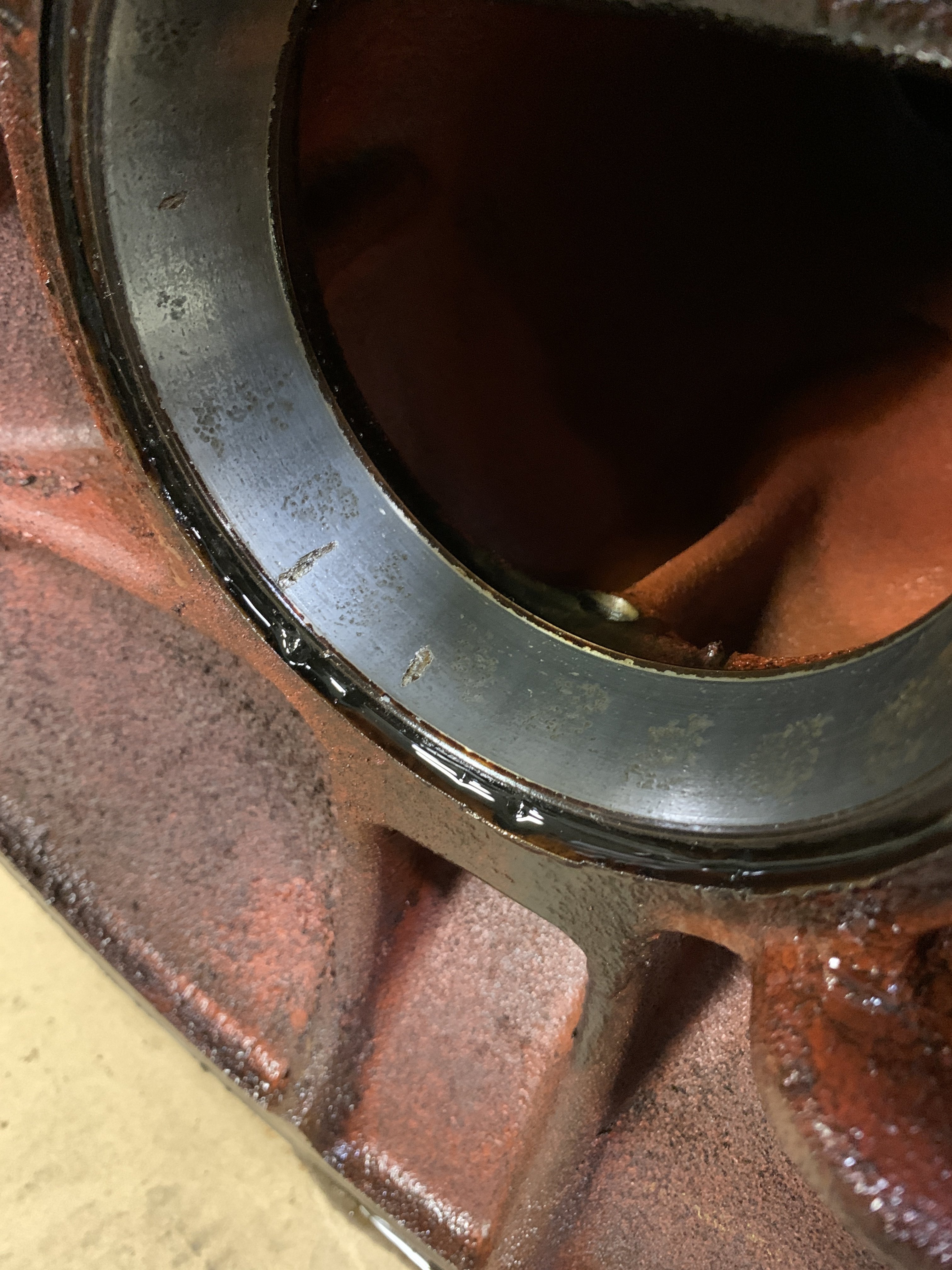

I will be replacing diff bearings. Looks like metal shavings must have got in that bearing or something. Probably didnt help either that the axle nuts were loose.
Those are usually caused by water in the oil sitting in between the bearing rollers and the race for an extended amount of time while the tractor sits for a long time unused. Oddly enough the bearing rollers rarely get the same damage as the race and you can get by just replacing the race.
