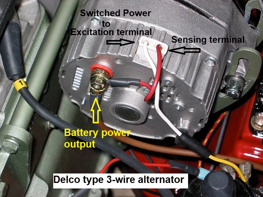

I want to put a 10si on it but the original plug was gone and somebody just put spade connectors and they were unhooked so how do I hook it up I found a thread on here but it was confusing to me what is the best way to hook it up pictures would be great
The picture below shows where the wires go. The switched excitation wire needs a diode, indicator light, or resistor in it if the power is coming from the same switch terminal as the ignition or a fuel shut off solenoid gets power from. Otherwise, back feed from the alternator to the ignition switch could prevent engine shutdown.

(Jim with apologies) You won’t have to worry about this because on those IHs you kill the fuel by moving the throttle left over the detent to the stop position, nothing electrical involved. Connecting the original GEN dash lamp to excite circuit on the 1 terminal gives you a charge/no charge indicator. The site I used with all the IH wiring diagrams got boo-boo’d and hasn’t been fixed to my knowledge so I can’t help you beyond that. The early ones had generators and the later had Delco 10DN alternators, both required a voltage regulator. Your two spaded wires may be for a 10DN and coming from the regulator. The lamp wire goes down to the regulator as well, it’s up under/behind the fuel tank or inside under the dash.

Not sure who’s reply your addressing. Jim’s reply 2 does inform the OP what is needed for the connections for a 10si install. I added in reply 3 that only a keyed source for the excite circuit (terminal 1) works and does not require an anti-feed back device. Whether the OP’s existing wires (or at least the required excite circuit) are plug and play would be up to the OP. If he is replacing an original 10DN, yes he would need to change the wiring from stock.
But won't he have to do something with the wires at the regulator if this has an external one ? I know some of the delcos that plugged in the back before the top plug ones were internally regulated but far and few. thanks
If the original was a 10DN (externally regulated with the plug straight in the back) the plug and wiring would be different. I answered the question of where the wires go on a 10SI with a picture. Without the info of what alternator is being replaced it is hard to say if wiring changes are needed or not.
I used the existing exciting wire that comes from the dummy light and it’s hooked to the number 1 terminal than made a jumper wire between the battery lug on the back of alternator to the number two on the alternator and it works fine and hooked up the ground

The indicator light wire should be on the 4th terminal (far right) it now needs to connect to the wire going to the #1 terminal of the 10SI to excite it.
You need to make a jumper to go between the #2 spade on the 10SI and the alternator battery post. The # 3 terminal wire on the regulator should be coming from a power source, tape it up so it can't short out. The regulator F (first on the left) and #1 wires can be removed.

# 2 was the remote sensing between the regulator and the 10DN alternator. #3 was a power wire to the regulator. #3 can be joined to the #2 wire at the regulator and the #2 wire end from the 10DN can go to the #2 spade terminal of the 10SI alternator for sensing, if one wants. It is not ideal but common practice on simple tractor system conversions is to use the jumper between the alternator battery post and the #2 spade. Either works and I agree the closer to the battery voltage is being sensed it can be a more accurate check of the system.
In post #10 reported he had the excite wire hooked up to the #1 terminal and had made a jumper between the #2 spade and battery post and it works fine.
