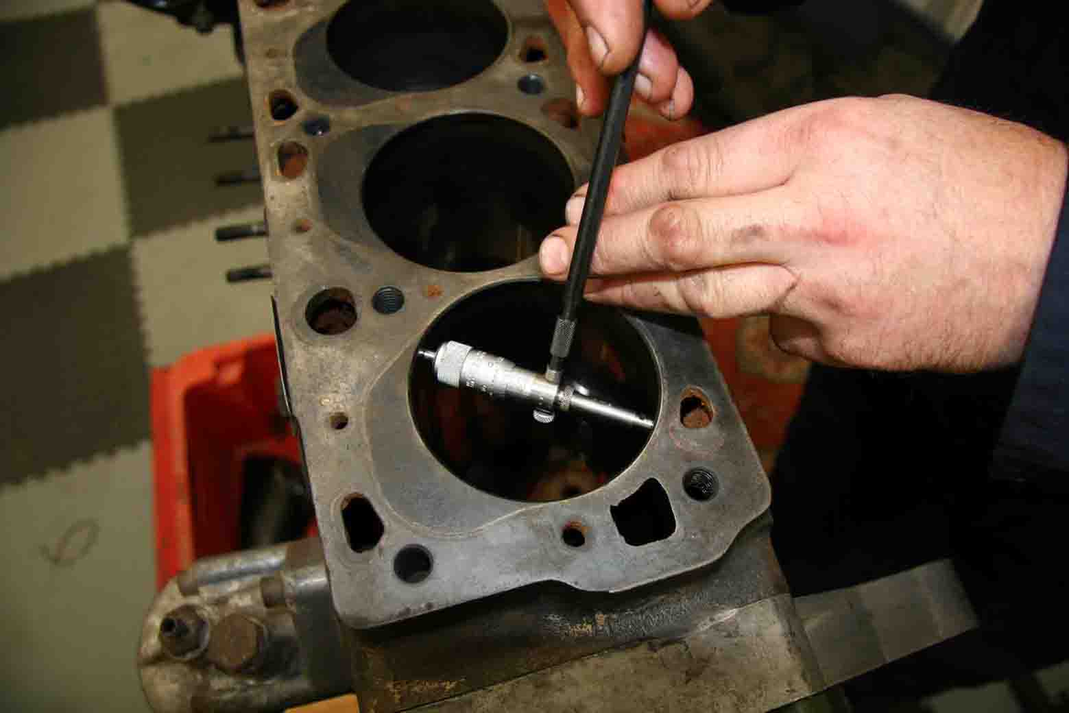

What are the inside readings of the liners both parallel to the crankshaft and perpendicular to the crankshaft. Taken at three points in the area the piston travels in the linner.
Say one inch down from the top of the liner...then mid travel ,then one inch up from the bottom of the piston travel

Farmall Dave: cheapest and not -too- time consuming way to assess the useability of your sleeves is to order a set of standard rings for one piston, and place them down in the cylinder and measure the ring gap. You should hone it first so that you’re measuring the true diameter of the cylinder. The ring gap will basically be your go/no-go gauge.

Like several others, I have them and use them, as well as a Starrett cylinder gauge.
I'm still adding to my tool collection and also learning a lot. Im reading and watching videos when I need some guidance on things and reading all the appreciated responses. I'm going to measure the inside of the sleeves today.

I thought u were going to hone them and do the measuring thing then u know if to spend big money or not. They don’t look that bad to me. And for just yard work it hardly justifies new sleeves and pistons. At least put a new ring at the top of ring travel then down at the bottom and that gives you a pretty good idea if they need to be replaced. If at the bottom u have .016 and .020 at the top you sure don’t need sleeves. Remember sleeves wear on a taper , with the most wear at the top so u understand what I am talking about.
