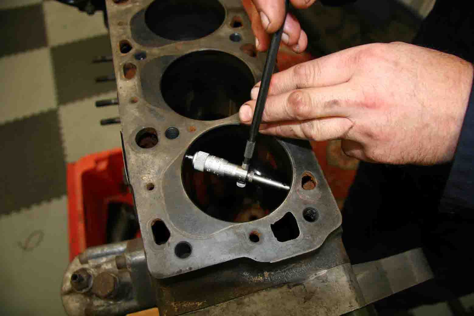

Hello again I have the head off the farmall bn. The tractor has always had steam come from the vent on the valve cover. I removed the head and noticed antifreeze toward the back with milky oil mixed. I cleaned the top of the block a little and the cylinder walls. I turned the engine over with the crank and noticed as the piston would rise to the top it would push a line of milky oil to the top of wall and leave it. It continues to bring up small line of oil each time. I feel like it may need new rings am I right or wrong. Thanks. I also noticed the head was easy to remove after taking the nuts off. I usually have a time getting the heads off.
Accurate measurements are required,so as proper components can be purchased.

How was your oil pressure? If it held good oil pressure you don't need to worry about rod and main bearings, at least not for now.
There are all different levels you can take this job to. Bare minimum would be to replace the o-rings in the sleeves and put new rings on the pistons. Next level would be new sleeves and pistons. Some will want to tell you the engine has to be sent to a machine shop to be pulled completely apart for a full work-over no matter what.

Ok got the pistons out and I'm not sure what to look for on the pistons to see if they would be ok to reuse. I did notice the exhaust ring on one of the pistons was broke when I pulled it out the top. The sleeves are very smooth. No cracks or lines that I can feel. The tractor will be used for parades and maybe pulling the manure spreader and JD 290 planter around. Should I go all the way new sleeves and pistons or just hone the sleeves and put new rings on the pistons. I want to do it once and be happy.
