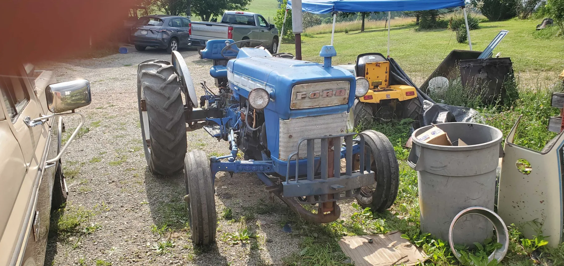

Looks like my '65 based on the grill. I think I see a power steering cylinder......you'll like that. Mine didn't so I added an aftermarket.....works ok but not like OEM I have on other Fords. The piping under the thing is owner added....can't make out what its for.
The thing underneath is the mount for a snow plow that was originally off a workmaster tractor and modified to fit. I ended up removing the plow since the moldboard had been replaced with a hacked up 3 point plow that weighed something like 1500 pounds and was stressing the tractor out really badly.
