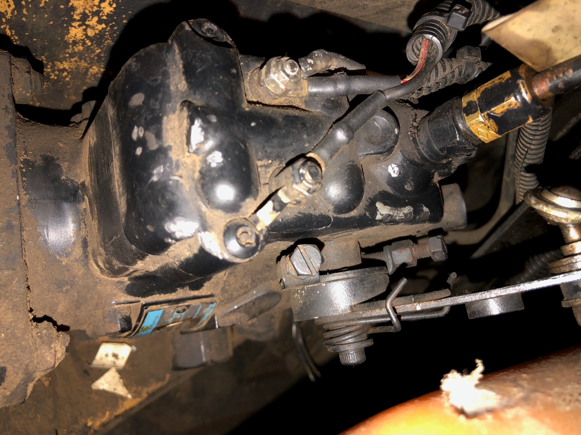

Hey there Dieseltech,
I have a Deere skidsteer with a little 2.9L four-banger in it. Said engine has a Stanadyne DB4 injection pump. We were using it the other day and everything was running great. Shut it down for lunch, came back and it would barely start and run. The engine WILL run, but only at about 400-500 RPM, barely. Nothing I can do on the outside will get it to run any faster than that. I barely have enough power to lift the bucket. It acts like something came disconnected inside the pump between the throttle arm on the outside and the metering mechanism inside. I have confirmed that the lever on the outside of the pump is connected to the throttle linkage and is rotating the shaft that goes into the pump. I have also confirmed that the lift pump is still working. It will run all day at 400 RPM.
I'm far more fluent with the CAV pumps than I am with the Roosie pumps. Have you ever seen something like that before, and/or can you speculate what went wrong? I'm hoping I can simply pop the top off and fix it without having to remove the entire pump. I plan to drill out the tamper-resistant Torx screws.
Full pump number if you're curious is DB4327-5658. Attached pic is as good as I can get due to the tight space. Thanks for any help you can be.

Hi Bern, How many hours on the pump? That one is built MUCH heavier inside than the other Roosa/Stanadyne pumps are. The drive shaft alone is about 300 bucks new as this model has a needle bearing/shaft drive instead of the brass pilot bushing/shaft drive. There's NO retainer ring to fail in this model pump either like the earlier pumps have. I'd first check the supply flow at the pump inlet, and if OK I'd then make sure the RETURN line back to the tank is not blocked/restricted anywhere as that would also shut the pump down, or at least limit the speed. There MIGHT be a chance the electric stop solenoid is not pulling the plunger/arm away from the metering valve as needed for the governor to have full travel, but that's not common. You might try a jumper wire on the pump hot post directly to the battery and see if that makes any change, a voltage loss through the key switch could keep the solenoid from pulling in correctly. I have the five star bolt tool and I would not try drilling the screw tops as they are very hard if I recall. Instead I'd use an air driven cutoff wheel and cut all three screw heads off to remove the cover. Screws are 10/24 thread, and HOPEFULLY they won't be stuck in the main housing as they sometimes are with dust/rust over time. Let us know what you find, there MIGHT also be broken pieces of the shaft wave thrust spring floating around inside, if so pump WILL need to come apart to repair it as I've seen that washer break before.

I'm unsure of the hours on the machine, it's not mine. I have plenty of pressure going in, and I have also checked the return fitting for blockage and found no problem there. Interesting theory on the shutoff solenoid, I'm going to try your direct wiring trick and see if that changes anything. The governor certainly acts like something internal is keeping the metering valve from freely moving, and I suppose a shutoff solenoid stuck halfway might do it. It'll be a while before I can get back on it, but I'll post back what I find. Thanks.

Engine should be a three cylinder, DB4327 means rotor has four plungers, three outlet ports, and .270 inch plunger size. There's another thing that could cause the metering valve to stick that I ran into on a genset awhile back. The transfer pump four blade/liner set were breaking down and sending fine shrapnel directly to the fuel metering valve. Pump would need torn completely down for hydraulic head passage cleaning when that happens too.

Shrapnel in the metering valve, possible I suppose. I still think I'll pull the top off and investigate before removing the pump. Does the cover just lift right off, or does one need to unhook a governor spring like on the CAV pumps?

Cover will lift off without unhooking anything. It CAN be a problem putting it back on though. The BEST way to install the cover is to energize the solenoid to pull the stop arm back, using two jumper wires, one hot and other ground. If not done carefully the stop arm will go on the WRONG side of the valve control rod and lock the arm in the full load position causing engine to run away at startup. When energized the arm is pulled AWAY from the control rod allowing governor weight/sleeve full movement. When solenoid is de-energized the solenoid spring moves the arm back to push the rod to the fuel off position. Energizing the solenoid and making sure the arm is pulled IN when installing the cover makes sure that arm is away from the rod when cover is replaced straight down on pump housing.

I do believe that it's governor related, and not inlet fuel pressure. It doesn't burp, hesitate, or misfire at all, it just sits there and runs at 400 RPM or so.

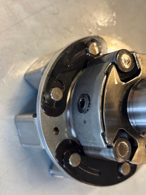

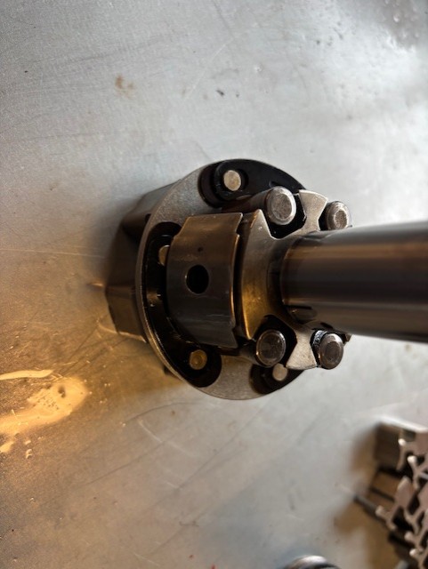

We're back on this Stanadyne pump we started on about a year ago. This time we pulled the pump off and disassembled it, figuring we'd find some sticking plungers. The plungers moved around fine, but what we did find was one of the leaf springs floating around, it had somehow come loose from the screw. The screw itself was in place, and we can not figure out how it popped out. Any ideas?
The two pics show both leaf springs, one attached on one side and the other floating around.

I'd replace BOTH SCREWS and the leaf springs. Owner is really LUCKY that head did not seize with loose parts floating around inside. My guess is the spring that came loose had screw hole damage or a bad screw to begin with. The four roller pumps are a real challenge to get them set correctly on the centrality gage too per the test specs. The new screws have a patch on the threads so they will stay put after adjustment is set.

OK, will do on the new parts. Have you ever seen something like that happen before? Does it make sense that this failure would cause my issue? It seems logical to me. Recall that it was running great when I shut it down one day, and then it barely ran the next day. Put it under any kind of a load and it would die.
As for the tricky adjustment, this only affects the max fuel setting, correct?

I've seen the screw heads break off, and leaf springs break in half but that's not common. When one side comes loose like what you have that will greatly reduce the max fuel setting and cranking fuel delivery too. The centrality MUST be set carefully on any four roller pump or there's a risk of head seizure as all four rollers should be set to within .002 inch of each other. There are different size roller shoes available to help with getting the settings right. The leaf springs/screws must NOT be bottomed out either, that's USUALLY the cause of screw heads or springs breaking.
