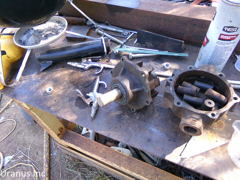

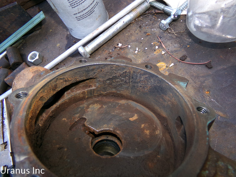

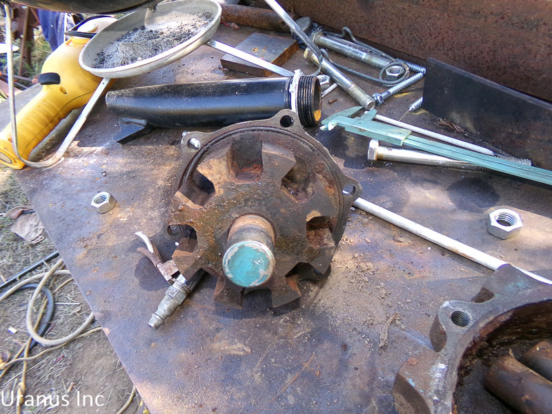

I said it was gonna be a journey...........................................
In my defense..........it's been a while since I needed it
Bit o' surgery, and we have VICTORY
