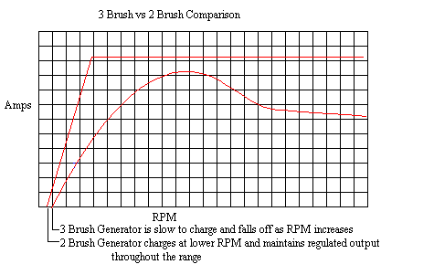

In the Three-brush Generators article, we discussed the three-brush charging systems, predominantly used on tractors in the 40s and early 50s. These produced fixed output based on the position of a third brush that limited how much output the generator could produce. This fixed output was turned on and off by connecting the field terminal directly to ground for full charge or through a resistor if a low-charge was warranted. This ground was indirectly controlled by the operator through a light switch. In short, if the generator field terminal was directly grounded, you would get full charge, if it was grounded through the resistor, you would get a partial charge. Since it didn't have any automatic control to allow for unusual conditions, inattention by the operator could easily let the battery get lower and lower over time or worse overcharge and damage the battery.
The third brush system had one other drawback. Since the fixed position of the third brush was the only limiting device provided to make sure the generator didn't run wild and burn itself out, it could not put out full current on high charge. It would not charge at all at low RPM and and at high RPM would dramatically drop in its charging output. The two-brush generator was applied to tractors in the late fifties to overcome these deficiencies. Unlike the three-brush system, the two-brush generator could achieve its true maximum output when the field was grounded. This meant that external controls would be required to keep it from burning itself out. This was accomplished by placing the current and voltage limiting controls into the regulator.
Simpler or more Complex?
The two-brush system was designed with a simpler generator by eliminating the third-brush, its spring, carrier and its wiring. As stated earlier, without that third brush, the generator (by itself) had nothing to stop it from producing full voltage at the current necessary to keep up with difficult demands like when you fire up a hard-starting tractor at night and immediately turn on the lights. This high output capability sounds too good to be true when coupled with the fact that it had less parts to wear out and was less complex. Unfortunately it is! This simplicity was more than offset by the complexity of the regulator. The third-brush system had merely a cutout relay to prevent battery discharge through the generator when it wasn't producing sufficient output. Beside that there was only the light switch resistor or a resistor in the regulator casing (you may have wondered why the regulator was so small on the old systems). The two-brush system needed more relays in the case and the wiring of the relays needed to interact. Lastly, the relay in the simple regulator on the third-brush system would occasionally kick in or out depending on the battery state or RPM while the voltage and current relays of the two-brush system would open and close up to 250 times a minute (later third-brush systems occasionally had this type of regulator also but on most tractors only a cutout relay was used). In general the two-brush system complexity boils down to the regulator being less user-friendly than those used on a three-brush system.

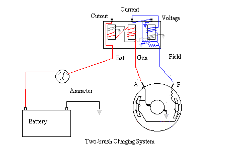

The two-brush generator was created by simply taking the wire coming from the field coils that would normally connect to the third-brush and connecting it directly to the wire coming from the brush on the output or A side brush (for this reason, it is called a shunt generator). By manipulating the ground on the field terminal side with relay-operated points, current would flow at full charge or not at all in rapid cycles. These cycles increased in frequency as current requirements dropped. From a visible wiring standpoint, nothing changed. It has a field (F) terminal and an output terminal (A). The field goes to the regulating device and the Battery terminal goes to the battery by way of the current relay, cutout relay and Ammeter. The main noticible difference is that the regulating device was now in the regulator and not in the light switch.
On occasion, some machines had three generator terminals. The third is a ground terminal that is provided to allow external grounding. Normally the ground for the second brush is internal through the generator casing. Due to the high resistance experienced from the generator mounting connection (rust, dirt and grime), using a seperate wire ensured a superior ground. This was used on high (24v) charging systems such as those used on large John Deere machines and many crawlers. Note that most references will refer to this type of generator as a two-wire even through there are three protruding from the case.
Regulator
The regulator on a two brush system has extensive interaction between the relays because they help trigger one another's opening and closing state. Now the complexity of the two-brush system becomes evident. It takes three seperate functions to make the system work to handle first the fully charged battery, second having a load such as lights turn on when the battery is up and last having a load and a discharged battery. To perform these functions there is a Cutout Relay, a Voltage Relay, and a Current Relay. These devices are all very similar in design being electromagnet relays. Depending on the direction of flow through their windings, they open or close. Though it is possible to combine the functions of the Current Relay and the Voltage Relay into one relay (called a two-unit regulator), it is best to see the functions discretely and so we well discuss the three-unit regulator.
Cutout Relay
The cutout relay is identical to that used in our old three-brush systems. It still opens when generator output drops below battery level to stop reverse discharge but in addition a shunt or wire to the voltage relay causes it to simultaneously close it's points and ground the field wire. This action causes the generator to increase its output which will theoretically will result in the cutout reaching its magnetic potential and closing its points again. It is important to realize that that shunt is not sufficient to cause the Voltage relay to kick in. It only helps. The primary thing that will make the voltage regulator kick in is discussed below.
Voltage Relay
The voltage relay, when open, allows the generator to have it's field grounded through a resistor. The charging rate of the generator is determined by "how much" the field is grounded. If through a resistor, a "low amount of ground" is provided to the generator and it charges less. When the field is connected directly to ground, the generator starts charging to its full rate. The voltage relay depends primarily on the voltage output of the generator to cause its points to open and reduce the ground by going to ground through a resistor. This happens because when the voltage passing through the electromagnet reaches the preset maximum for the windings, the opening of the points causes it to drop off in voltage until the cutout relay opens helping it to return to its closed state. This cycle is the normal one repeated during times when the battery is up or the load is light.Note: The voltage relay connects to the F terminal of the generator to apply voltage to its windings.
Current Relay
What happens when the load is high and the battery is low? Basically, when the current draw is very high (such as a low battery and high load), the voltage will never reach the level necessary to open the voltage relay points and relieve the poor generator. As with any "wide-open" running, the generator would meltdown. This is where the current relay comes in. It's points are wired in series with the Voltage Relay's points and will handle these unusual times by opening its points when the current reaches a certain level. During these load times, the current relay breaks the direct ground and runs to the resistor in the same way the Voltage relay would have under normal conditions. This allows the generator to rest which causes the generator voltage to fall below battery voltage and opens the cutout relay. The current relay then closes again (current has fallen) and the generator starts kicking itself up again. You can see the the current relay and voltage relay do exactly the same thing, but do it for different conditions and never do it at the same time. Either the voltage relay is working or the current relay and the points of the one not working are always closed. Note: The current relay measures its current by its windings being connected to the A or output terminal of the generator.
