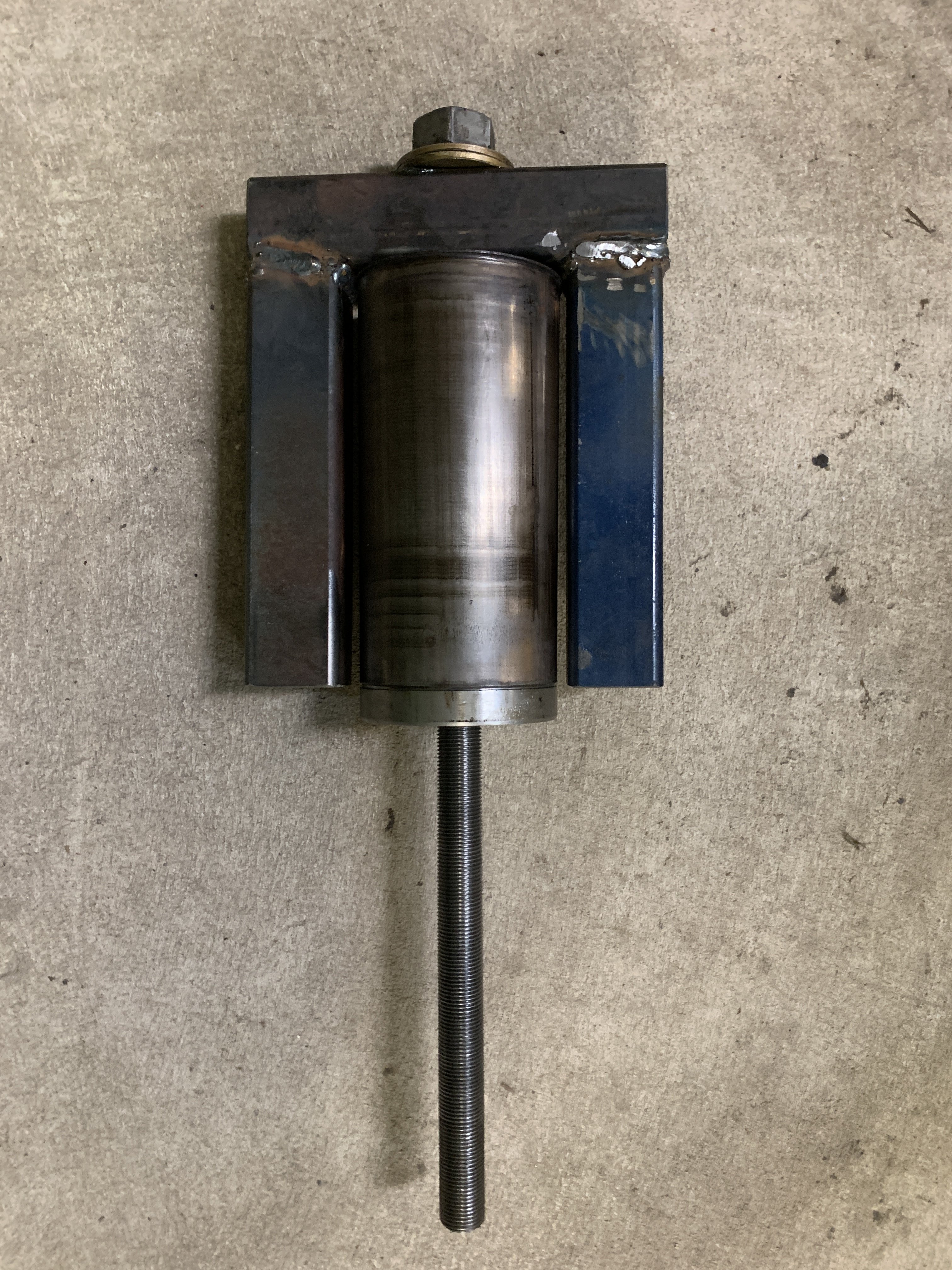

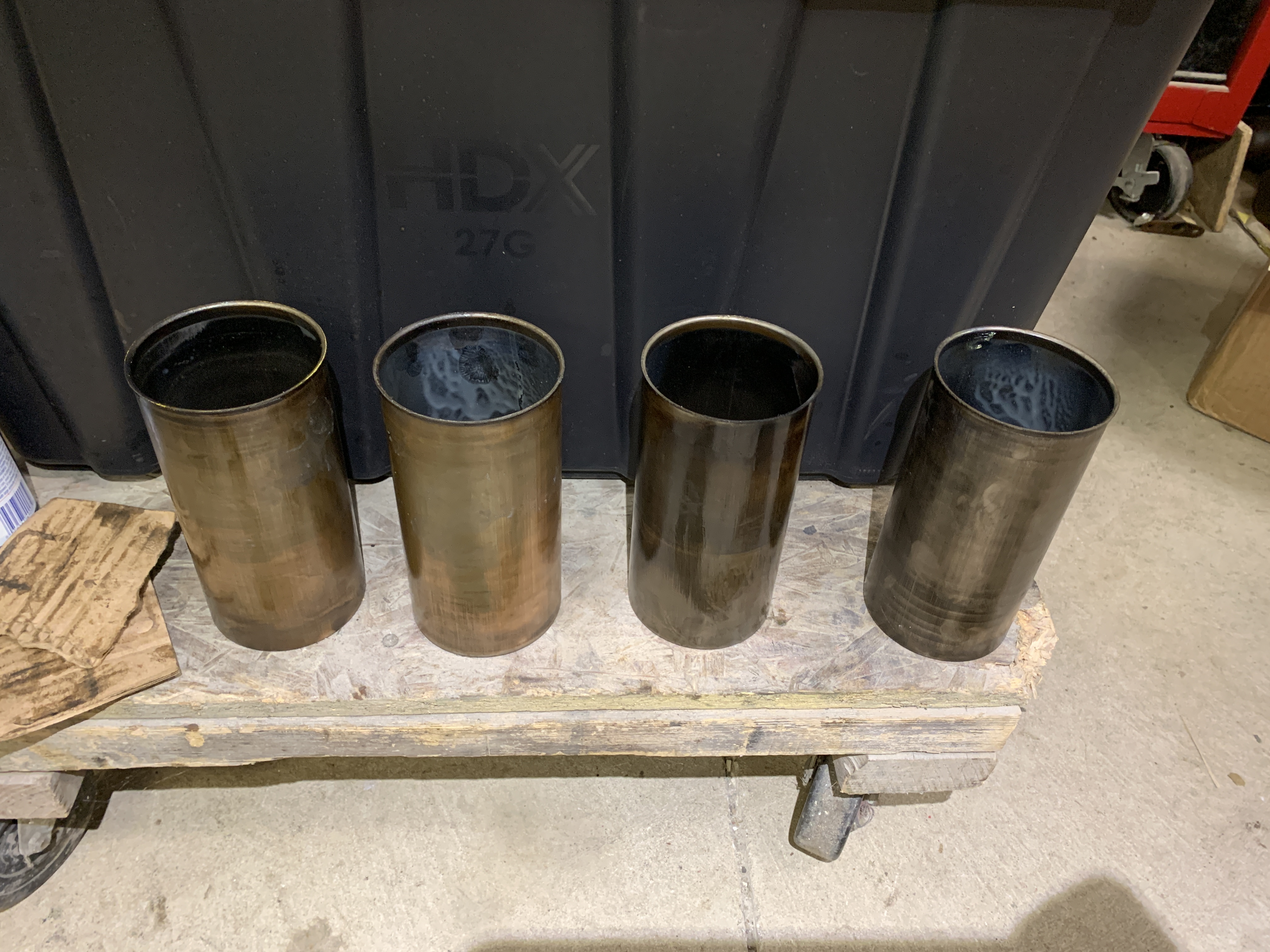

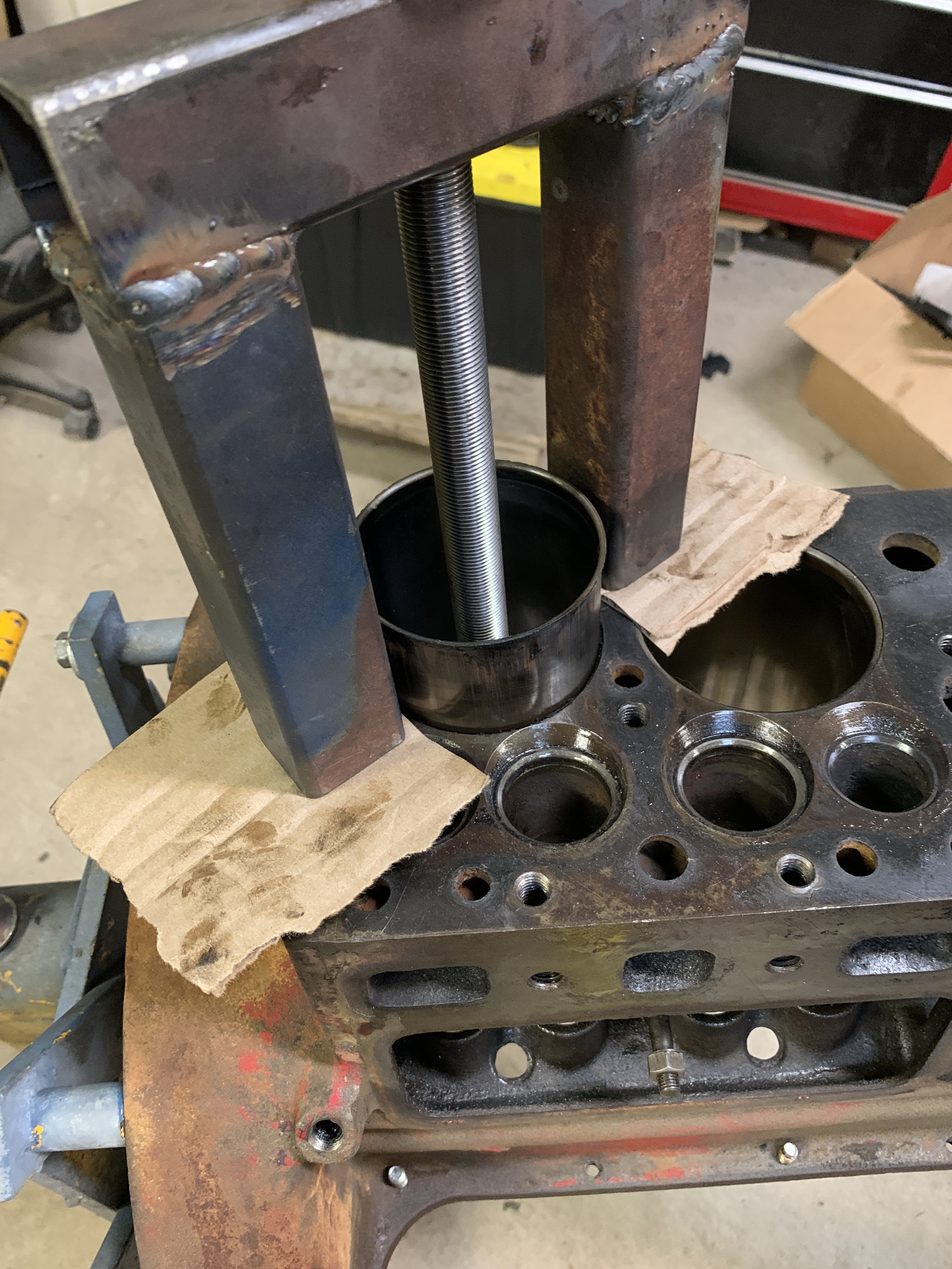

Welded together some scrap metal I had today to make the sleeve puller. All the sleeves are out now and once my rebuild kit comes in ill take it to the machine shop.
1 and 3 were a little loose compared to 2 and 4. Glad I am going with the .090 sleeves.

Good deal, I did my first with a welder and ho-made driver. To me making tools is part of the fun the fun part. I am not going to put a potential problem back in there ring it up as the cost of doing businesses.

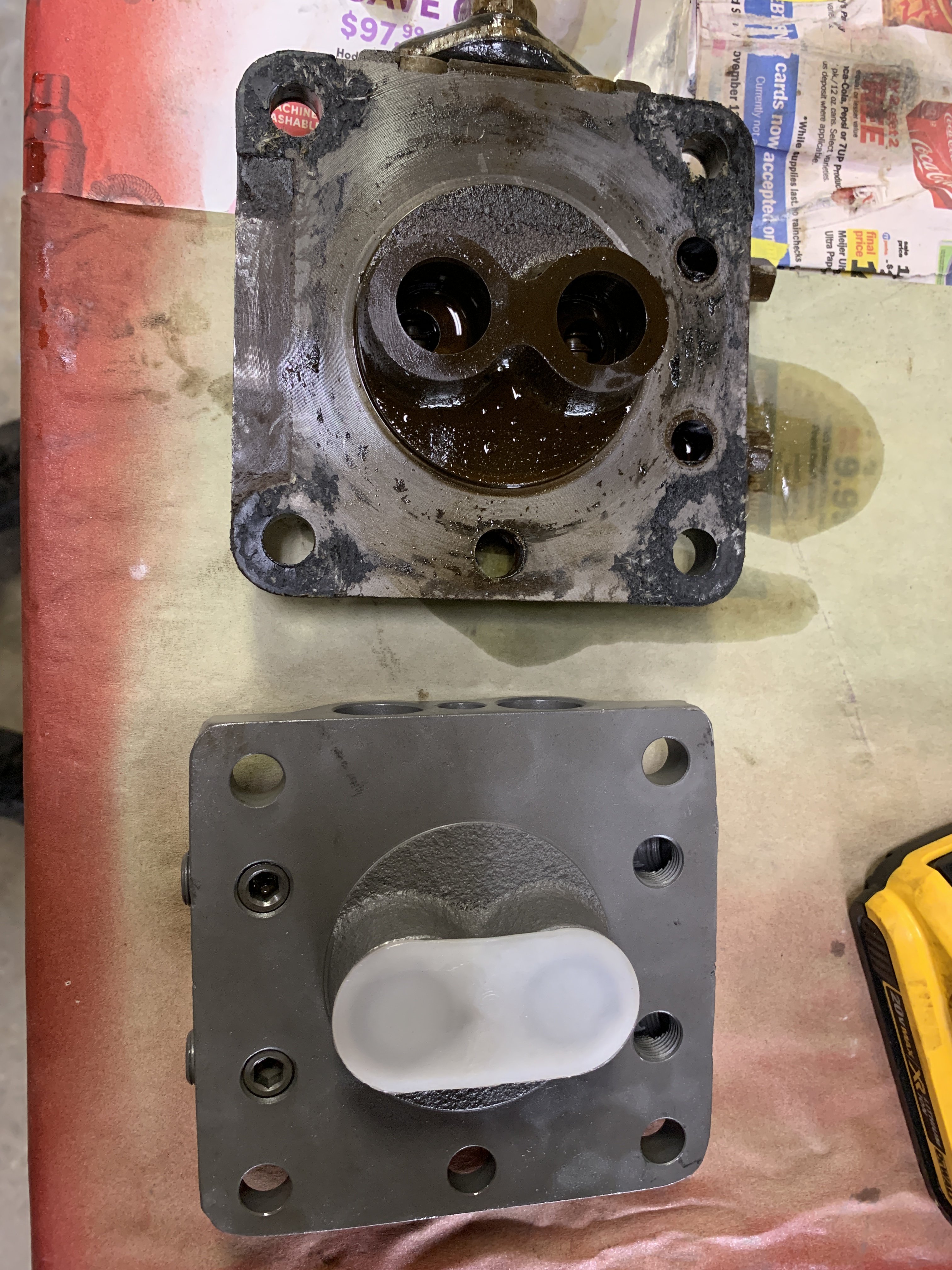

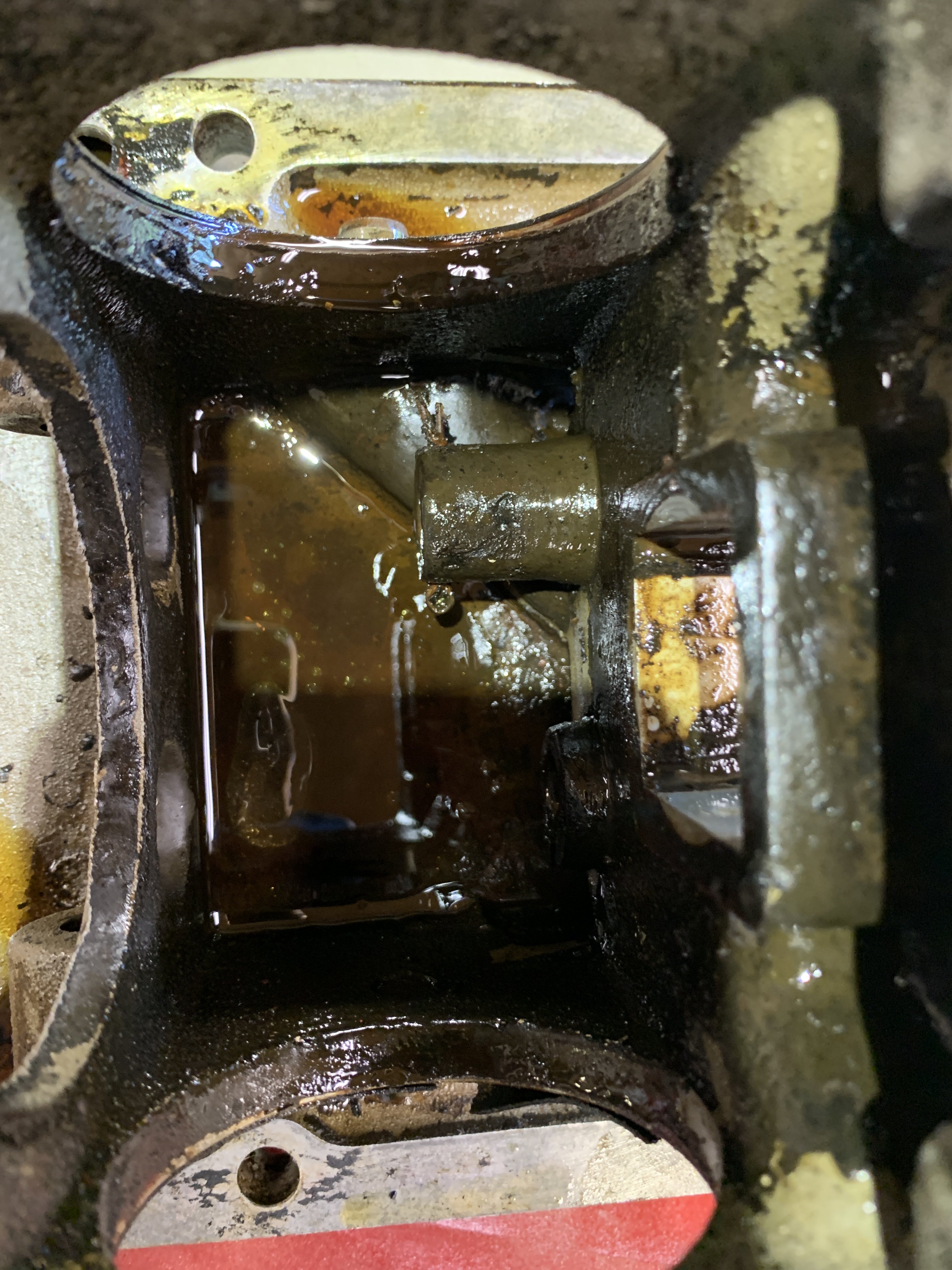

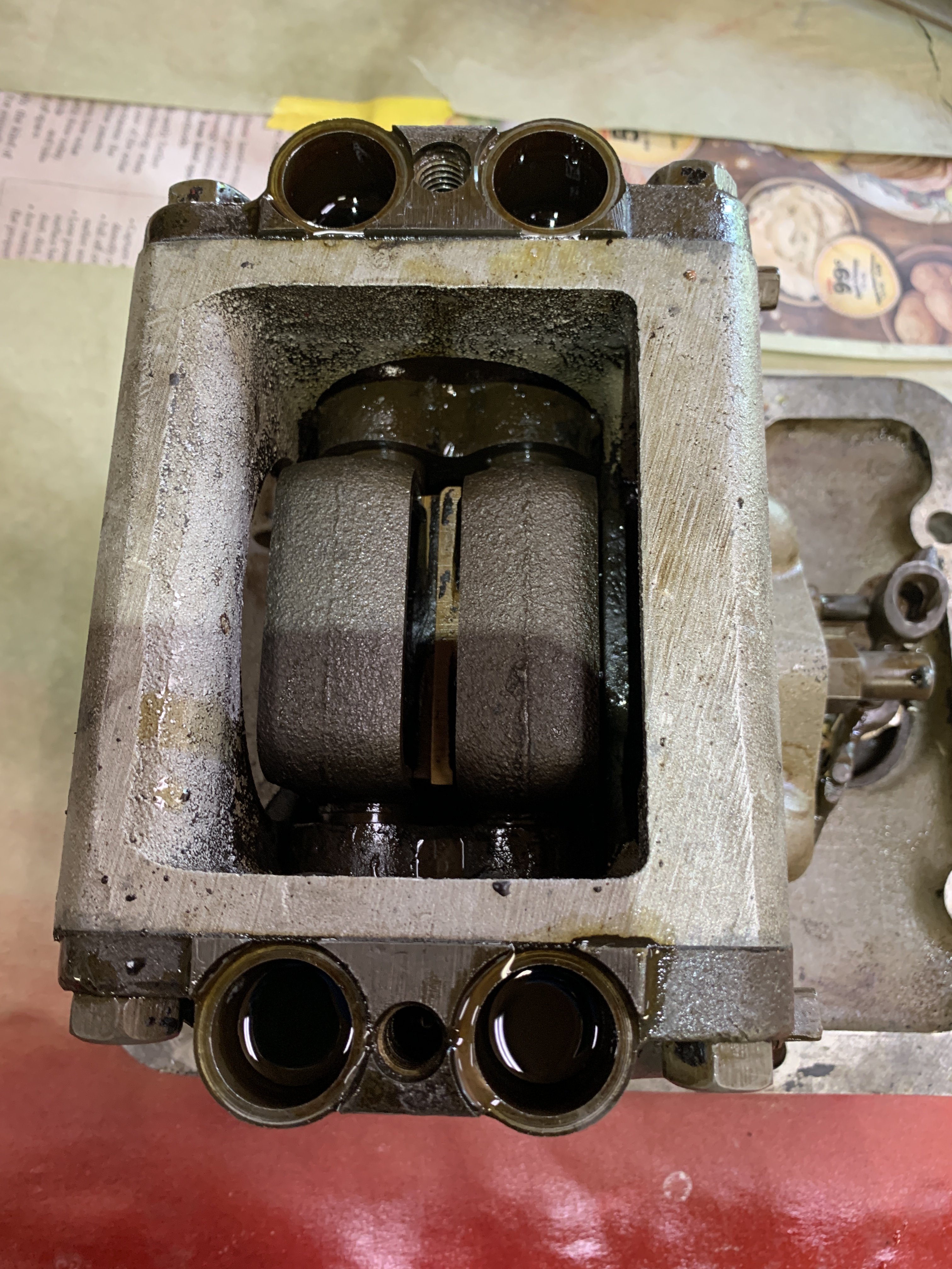

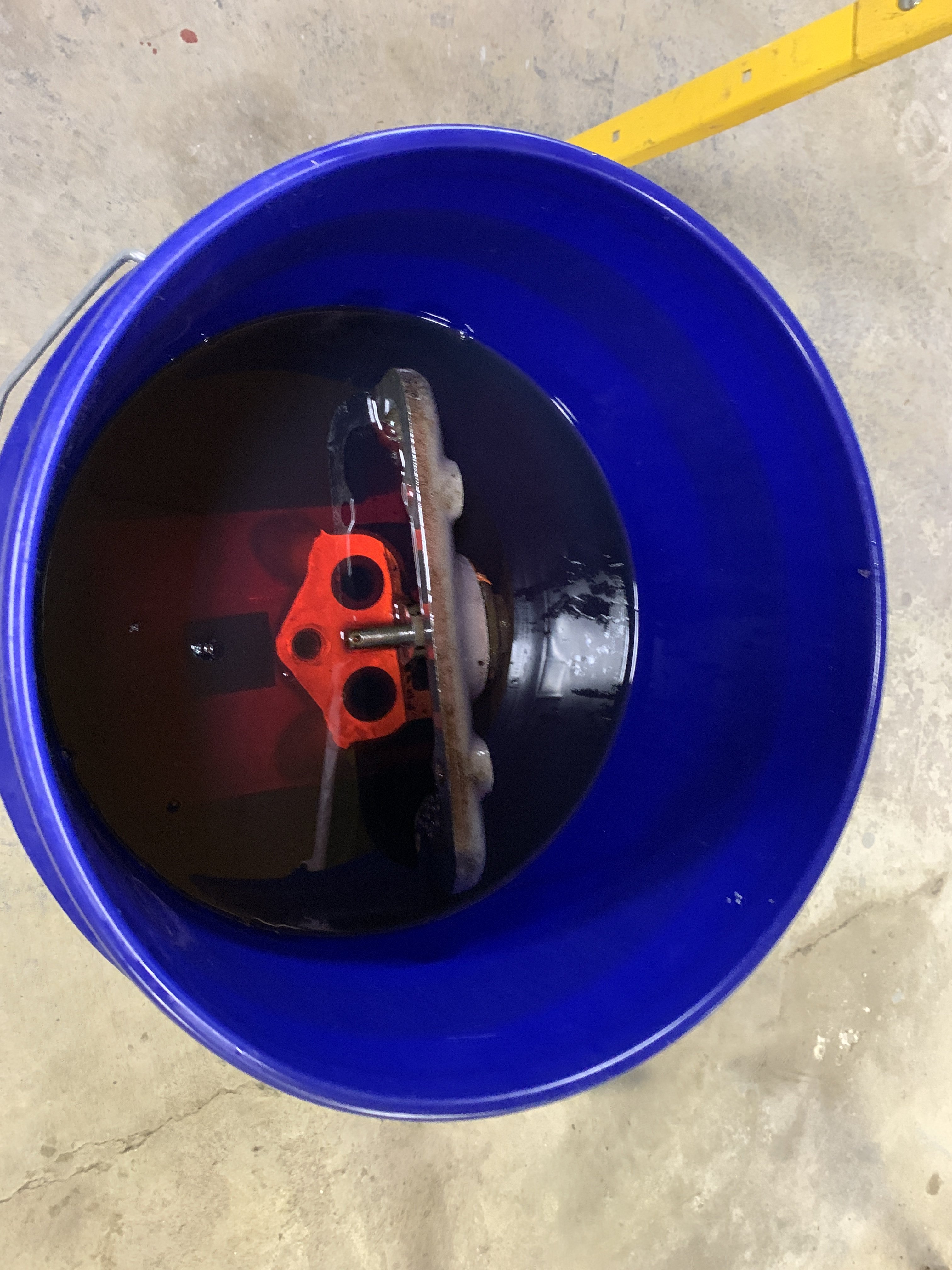

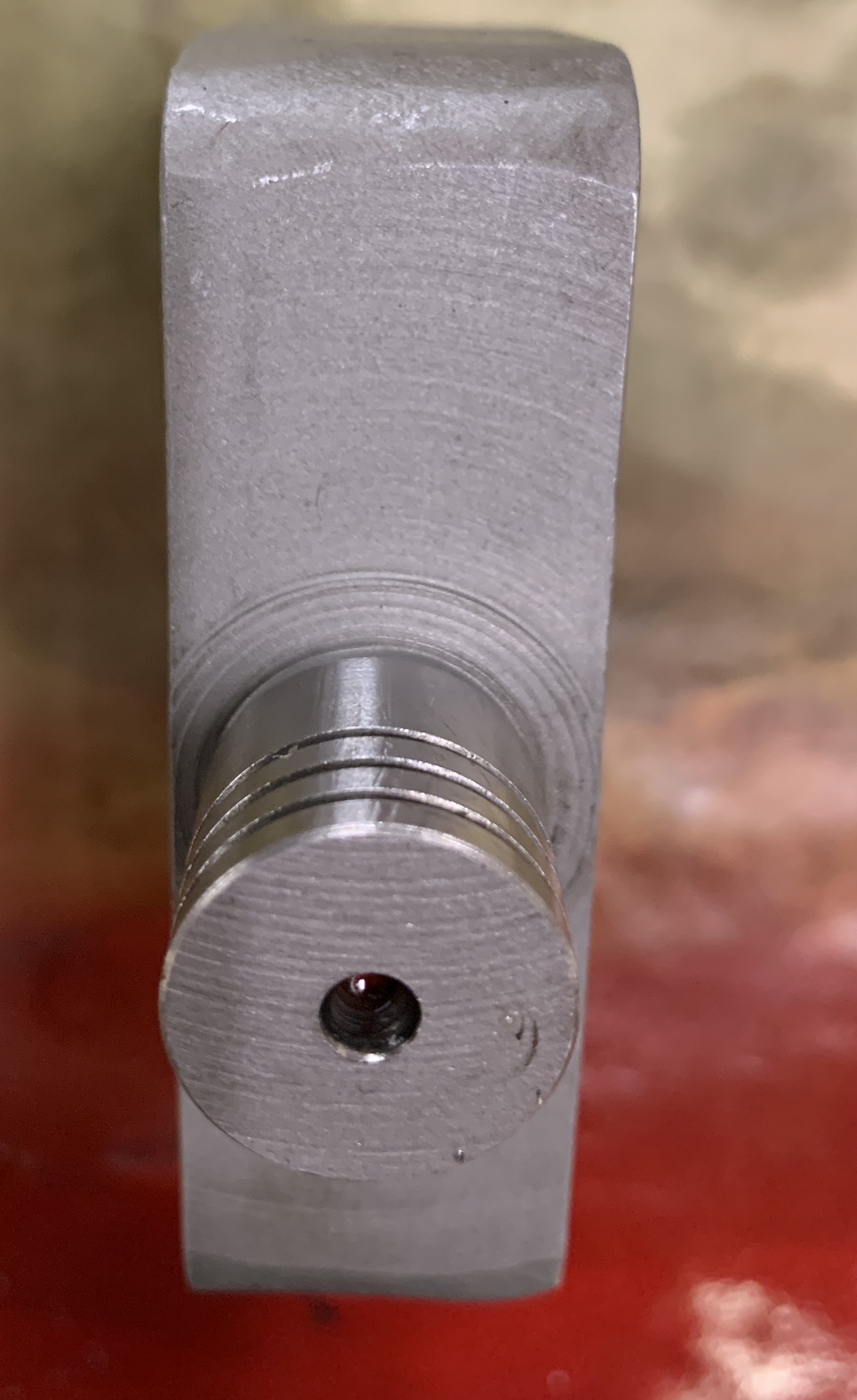

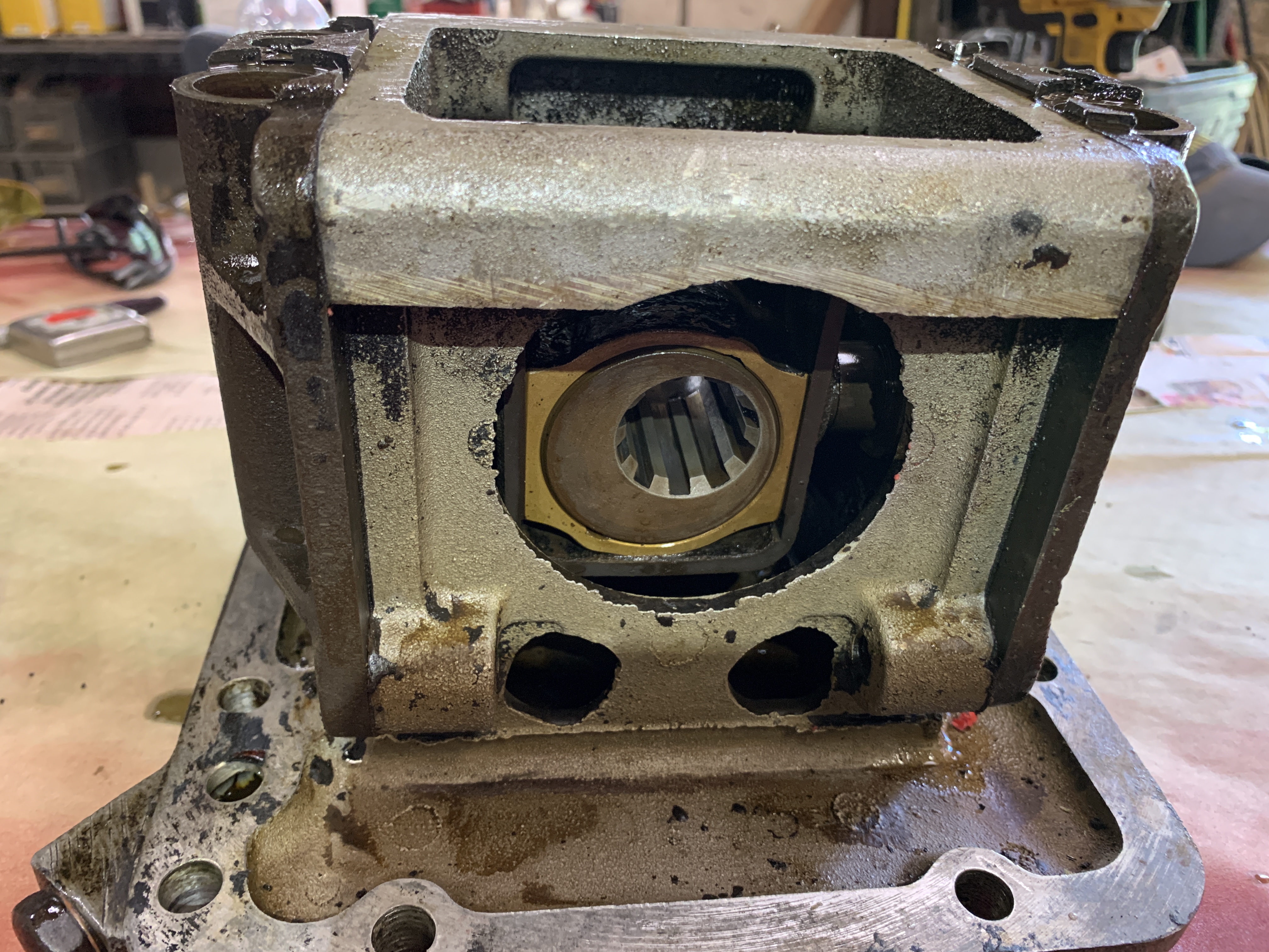

Took apart the hydraulic pump today. Got it soaking right now in diesel and ATF. New rebuild kit I got looks pretty nice.

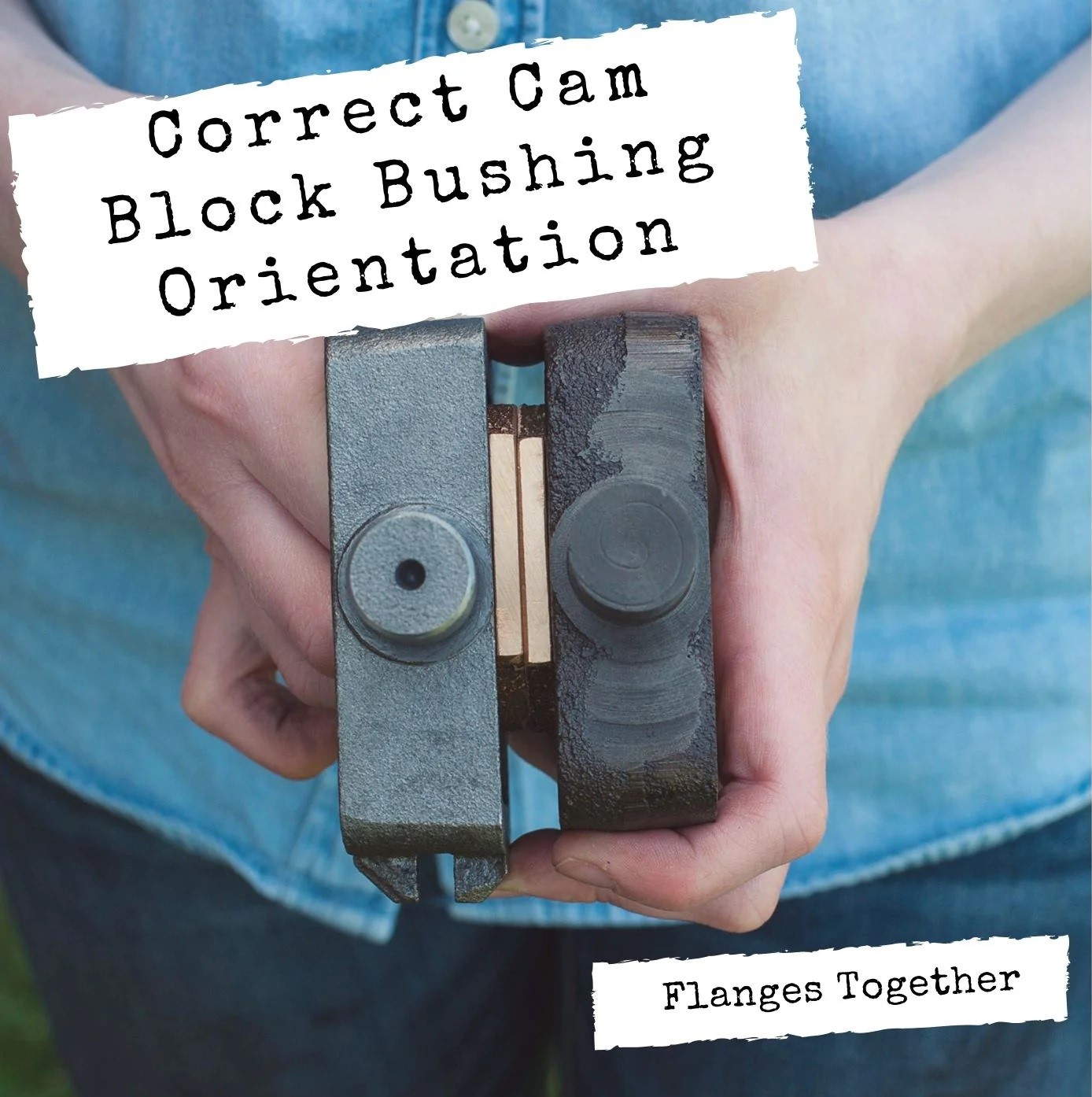

I am sure you have this covered but maybe I can save you a headache by sharing that the first time I worked on this pump I missed this Shop Manual Note: "The pistons on the scotch yokes are off center. Position the scotch yokes so that the pistons are at their closest position to each other." You guessed it, I had to redo my work. Back when I had zero experience I was mimicking a video on U tube that assembled them incorrectly. Lesson learned. I still use U tube but I always make sure I read and understand the shop manual before tearing into something.
Thanks for the tip. Did you update the youtube vid? Lets see it!
It is hard to see unless you know to look for it. The J&D video now has a mention of the discrepancy in the text that follows the video.
Ahh at first I though you said you made a Youtube video!
Looks like they may even have it wrong on their website. The one on the right looks to be closer to the outside.
If you look at the yoke on the left that she is holding what are the tabs for on the bottom? The original ones do not have those and in the J&D video it says to make sure those are down when installed.
