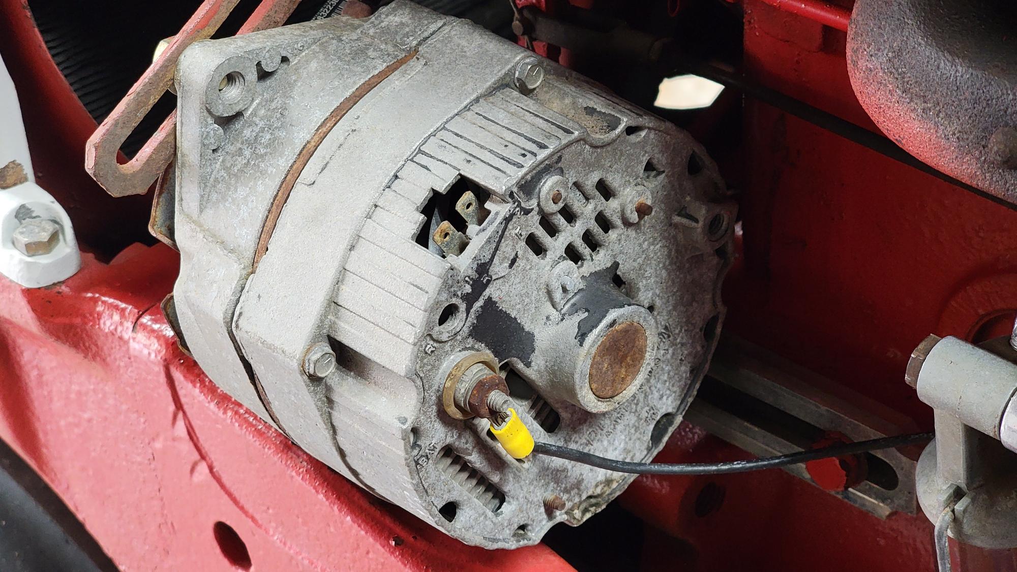

In reply to NYQUIL post from below, I thought Id start a new thread. It is all important info every Ford Tractor Owner should know and have for reference so feel free
to copy and paste it in your own folder. The reason you cant find any official FoMoCo wiring schematic or diagram with a 12V setup is because they never used a 12V
system until the late 1950s and only on the new diesel models. JMORs WIRING PICTOGRAMS are the only credited wiring diagrams that have every correct way to wire
these FORD tractors. Perhaps the most misunderstood function on vintage FORD vehicles is the 6-VOLT/POSITIVE GROUND ELECTRICAL SYSTEM. It uses a 6V battery; a
Generator; a Cutout Circuit, or Voltage Regulator; an AMMETER; Ignition Switch; a Coil; a Ballast Resistor (only on Front Mount Distributor); a Starter Motor; a Safety
Start Pushbutton; no lights***; and all wired correctly. The Ballast Resistor was discarded when the Angle (Side) Mount distributor was released. Side mounts now had
a passive junction block behind the dash that connected wires to terminal posts. It is a fact that 99.98% of all non-starting issues are due to incorrect wiring
whether 6V or 12V. Fellas get into trouble with non-starting issues and dont know or how to troubleshoot the system. Many rely on misinformation that they need to
convert to 12V or an EI system and then often end up with even more problems when done wrong. There is nothing wrong with a 6V/POS GRN; a 12V/NEG GRN; or even an EI
setup as long as the wiring is correct. 6V and 12V each have their PROS & CONS. EI simply eliminates the need to use breaker points. If wired wrong, it will fry the
expensive unit. Using whatever setup you choose is fine as long as you know how it was originally and you change our for all the right reasons. With 12V that means a
faster spinning starter motor, stronger starting a weak engine, brighter lights, and capability to run your 8-TRACK player or other 12V equipment on it such as a
sprayer. With EI I personally have never had a want or need to switchover as I know and have done hundreds of distributors with points in my life. Having my own
tractor repair business, Ive worked on several tractors that have had 12V switch-out jobs done but tractor did not run due to mucked up wiring. Many think they
know how to wire a circuit and most turn out to be guessing, wrong, or let someone else do it who also doesnt know. There are only a few correct ways to wire a 12V
system and a hundred incorrect ways. When doing a 12V job and using the 6V coil, you need to add an inline external 1-OHM resistor to the coil circuit. Eliminate the
extra resistor simply by swapping out the 6V coil for a certified 12V coil. On the front mount systems, you need the OEM Ballast Resistor in the circuit no matter if
6V or 12V.
