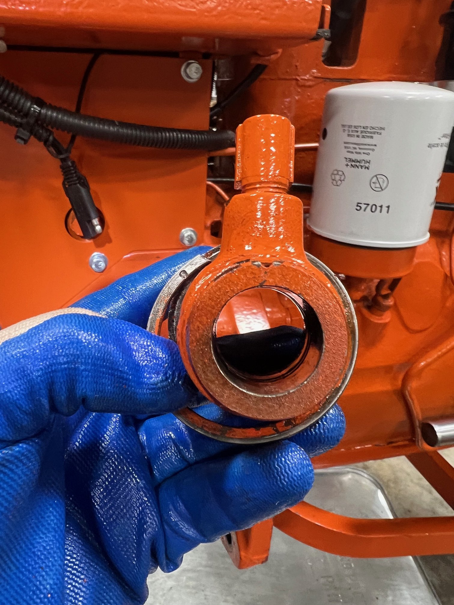

Ok - finished a total restore on a 59' D14. All is well, runs great, tranny shifts great, lots of fun. Of course life is usually good at giving us a problem. This was leaking oil from every single one of the seals, gaskets and o-rings. When done and running , looks like we are all good except what i think is an oil leak on the bottom of teh steering control valve. See the three ball bearings in the picture above. I rebuilt this unit about a year ago as part of the total overhaul. I don't remember these balls coming out, and candidly, the parts page barely shows them (seen above the #20 in the pic). So the question is what to do.
i don't remember any springs, etc above them. i'll assume from the picture that they are simply setting in a recess at the bottom of the pump. Anyone have
experience with these ? Odd there are no part numbers for them either. Thanks for all help.

They are there to plug a drill hole to make an internal passage. They are not intended to be removed. If they leak you may have to take the valve apart and weld them to stop the leak. They seldom give trouble, are you sure the leak is not from something else?
No, I’m not. I’ve gone through exploded ire of the steering motor and besides that there is little above it that might be causing this. There is one seal at the rear of the steering motor where the steering shaft goes thru. I did replace that seal on the rebuild but I still remember thinking wow, this is a super wimpy seal . I clean off the bottom of the steering motor ,start it , run for anew monies , and bingo more oil on the bottom of this . I guess that one guess-test would be to silicone over those theee balls and see if the leak lessened . I personally think I’m leaking from somewhere above
So I would clean it with brake clean or ether and get it completely dry, use a blow gun with air and make sure completely dry, then start engine and get under and watch up for first sign of leak. The elbow is tapered pipe thread, may be cracked or just leaking in threads. The three line fittings are inverted flare, they some times like to seep, can be easily cross threaded, the two directional lines have separate seats in the casting that could be bad or the flare on the line could be bad. Keep looking. It is coming from somewhere. Great paint job. Would like to see complete tractor.

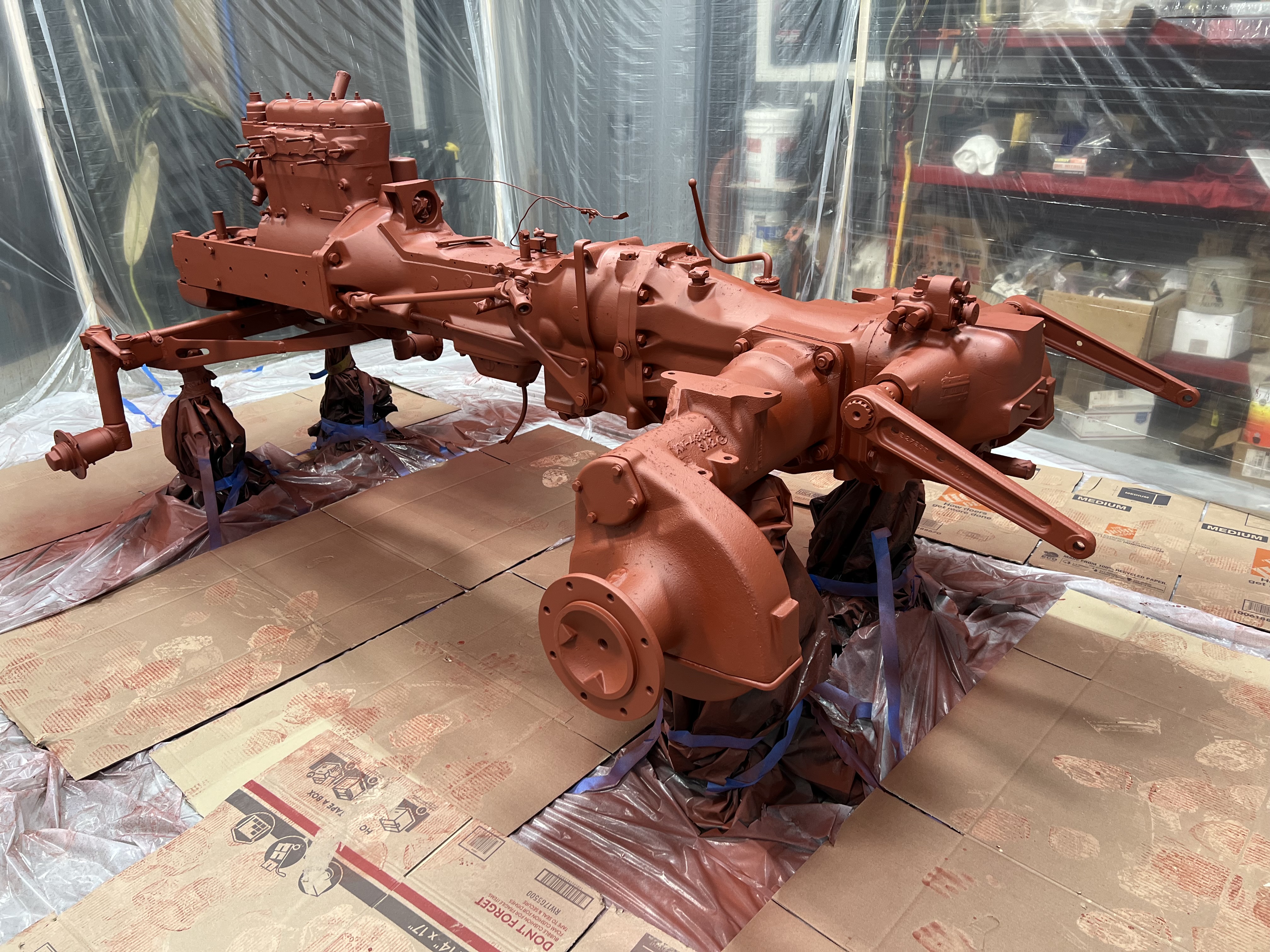

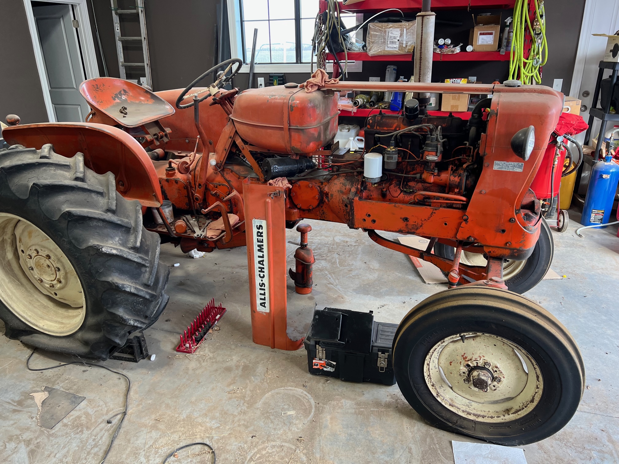

Well, drug this home non-running . Didn't know boo about A.C. tractors, but some study lead to the tear down. Originally, i was just going to "see if i could get it to run" . You know how that goes - once stripped, it was then well, torn down this far, maybe i should get out my paint equipment. Built a tent around the tractor , spent a ton of time stripping, sanding, bodywork on the fenders, etc.. Final product is near flawless, and grabs the attention of anyone that comes in the shop. Had a good time with this, and still am amazed at the technology of the 1950's . Last detail is to find this leak . thinking the exact same thing that you have prescribed. Gonna have the Mrs. sit on the tractor and rock the steering wheel back and forth a little to see if the control motor starts to leak or will the adventure lead somewhere else......

I'll bet your leak is running down from another area. I've never had an issue with those drive in ball plugs.
Think you are right. Going to exit work early and use my scope to look on top and fingers to look below.
I , too, think i have a leak up the ladder. i'm leaning on the seal that the steering column goes through. It is
remarkebly frail and i notice the actual column shimmys a little while turning. i'm looking there first. I really hope it isn't
from that spot. New seal, and it leaks is not a great combo.
